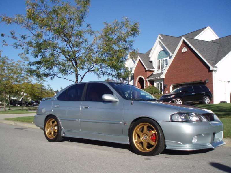

i painted mine with a gun last summer and then cleared them and they were the same color all summer. didnt chip or anything
heres a pic its gold too lol got the paint from napa
http://i4.photobucket.com/albums/y133/naaby2687/th_centralterminal035.jpg
http://i4.photobucket.com/albums/y133/naaby2687/th_rims001.jpg

Heres a photo of one of my rims:
Mark Supra uploaded this image to
Only takes 2 cans to do all 4 rims as well.
