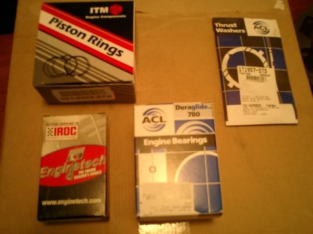

Went thru PartsDinosaur.com
Built my own kit with ITM pistion rings and Enginetech rod bearings

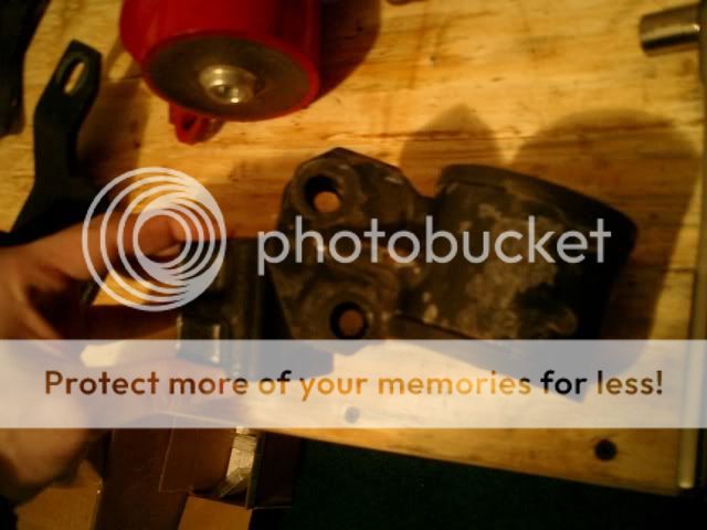

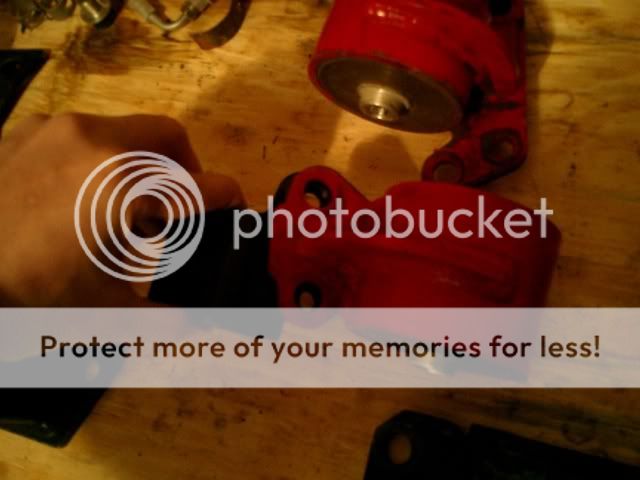

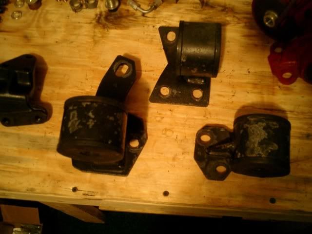

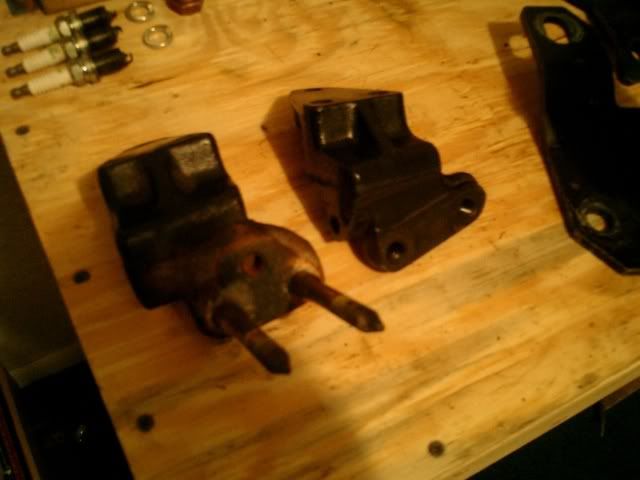

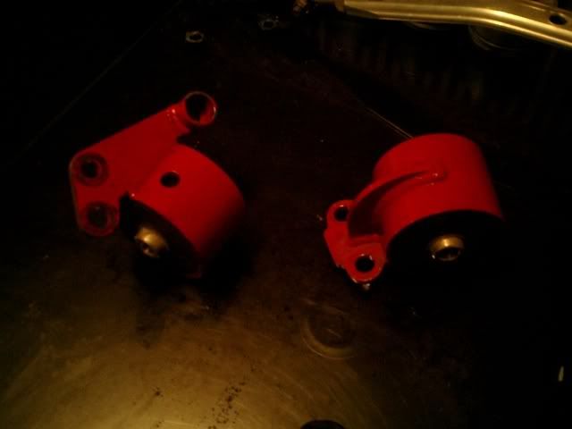

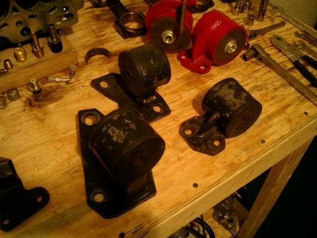

Trying to figure out what I need to get this B16 into a 88 EF CRX. I picked up these black motor mounts and was told they are for just that but they don’t seem right to me. The first two pics are the driver side bracket that bolts to the block, the one is a GSR but I don’t know what the other is from. Neither seem to work with the black mounts? Then I picked up theses red ones for cheap which came out of a 92-95 Honda civic but I don’t know what motor… Any help would be appreciated

your best bet is to buy a new set of hasport mounts or something else new that you know is for that chassis
That would be the easy way and the more $$$ way
next
are those d-series mounts? they look familiar. d16-z6?
I was told they were used in a B-series CRX?

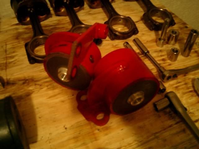

[SIZE=2]This mount works with the none GSR bracket
http://i197.photobucket.com/albums/aa271/shrekb18/ProjCRX017.jpg?t=1231423062
This one would work except they don’t line up parallel
[/SIZE]http://i197.photobucket.com/albums/aa271/shrekb18/ProjCRX018.jpg?t=1231422947

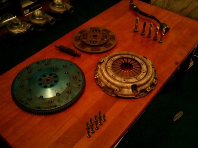

Got some new parts in! Hoping to get a lot done this weekend!
http://i197.photobucket.com/albums/aa271/shrekb18/CIMG0001.jpg?t=1231992225
http://i197.photobucket.com/albums/aa271/shrekb18/CIMG0002.jpg?t=1231992843

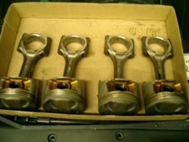

Got the pistons back today
http://i197.photobucket.com/albums/aa271/shrekb18/CRX200.jpg?t=1232076941

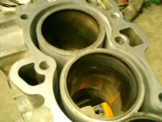

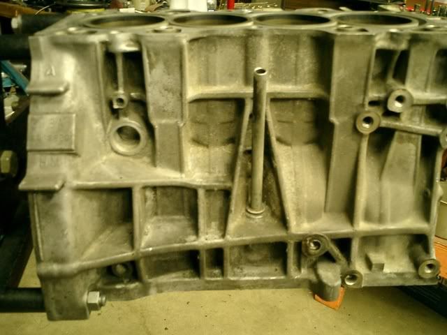

The block befor cleaning
http://i197.photobucket.com/albums/aa271/shrekb18/CRX205.jpg?t=1232077047
http://i197.photobucket.com/albums/aa271/shrekb18/CRX204.jpg?t=1232077098
http://i197.photobucket.com/albums/aa271/shrekb18/CRX201.jpg?t=1232077161
http://i197.photobucket.com/albums/aa271/shrekb18/CRX202.jpg?t=1232077212

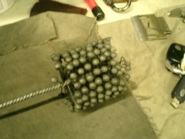

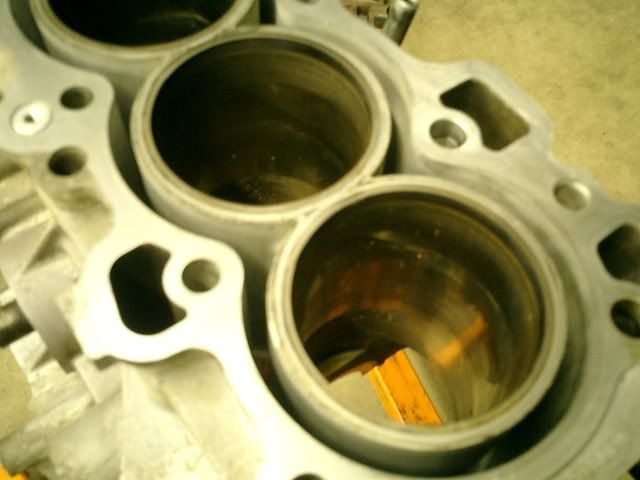

Going to Ball hone to clean up the bores
http://i197.photobucket.com/albums/aa271/shrekb18/CRX206.jpg?t=1232077258

are those drop in rings or file fit?

I don’t know, I will check the gap regardless
Yes thanks, Im still working out this motor mount stuff. Anyone know how to tell T-brackets apart buy looking at them?
I have confirmed these number at two different sites. I just have to figure out how to identify them. The one I have doesn’t have any numbers that I could see.
Rear Transmission Bracket Part # 50827-SK7-020, '90-'93 Integra non-VTEC
Rear mount bracket 50827-SK7-020 JDM XSI/ 90-93 Integra
What about the mount that bolts to the block on the driver side… How many different ones are there?
