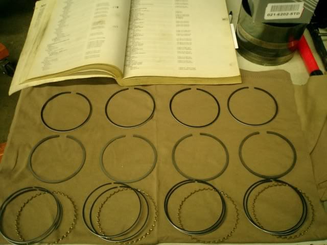

http://i197.photobucket.com/albums/aa271/shrekb18/CRX300.jpg?t=1232169839
http://i197.photobucket.com/albums/aa271/shrekb18/CRX301.jpg?t=1232169856
http://i197.photobucket.com/albums/aa271/shrekb18/CRX302.jpg?t=1232169885
http://i197.photobucket.com/albums/aa271/shrekb18/CRX303.jpg?t=1232169916
http://i197.photobucket.com/albums/aa271/shrekb18/CRX304.jpg?t=1232169962
http://i197.photobucket.com/albums/aa271/shrekb18/CRX305.jpg?t=1232169999
http://i197.photobucket.com/albums/aa271/shrekb18/CRX306.jpg?t=1232170026
http://i197.photobucket.com/albums/aa271/shrekb18/CRX307.jpg?t=1232170060
http://i197.photobucket.com/albums/aa271/shrekb18/CRX308.jpg?t=1232170342
http://i197.photobucket.com/albums/aa271/shrekb18/CRX309.jpg?t=1232170108
http://i197.photobucket.com/albums/aa271/shrekb18/CRX310.jpg?t=1232170128
http://i197.photobucket.com/albums/aa271/shrekb18/CRX311.jpg?t=1232170161
http://i197.photobucket.com/albums/aa271/shrekb18/CRX312.jpg?t=1232170187
http://i197.photobucket.com/albums/aa271/shrekb18/CRX313.jpg?t=1232170214

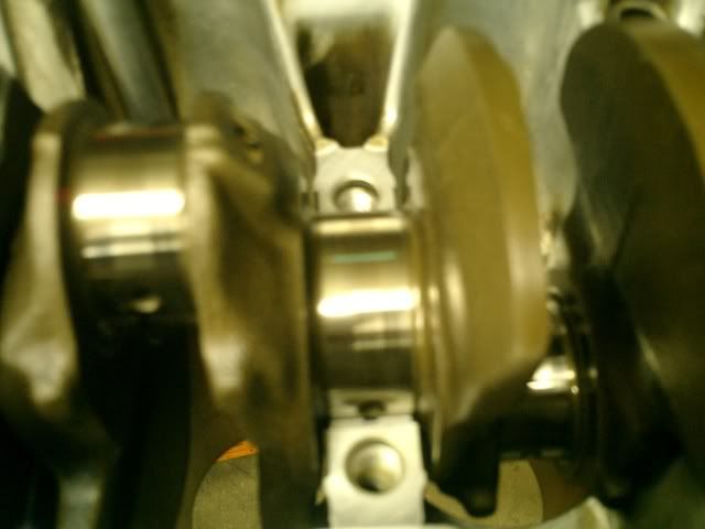

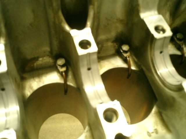

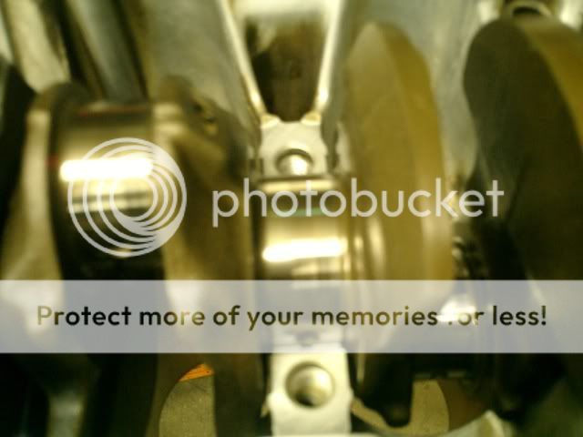

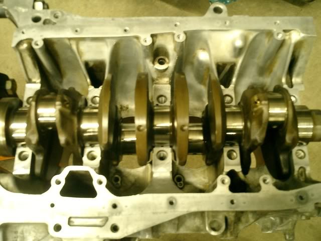

ya probably did but did you plastigauge the bearings?

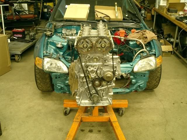

Well as soon as I can but there’s a whole nother half to this.

You have to look close but its there!

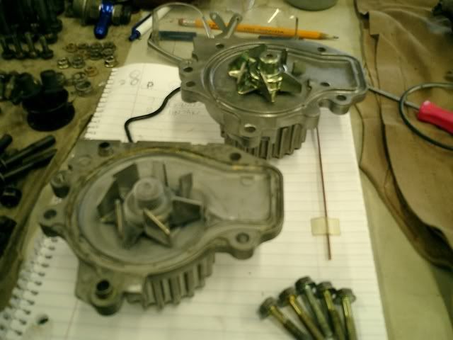

The water pump I was going to use didn’t have the alignment dowels so I just used the one I had from my other car.

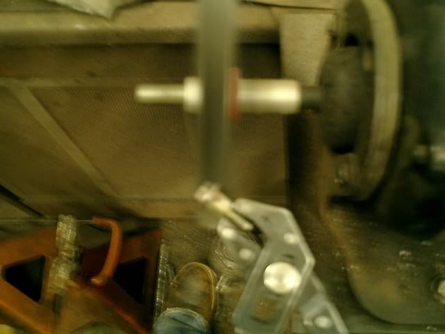

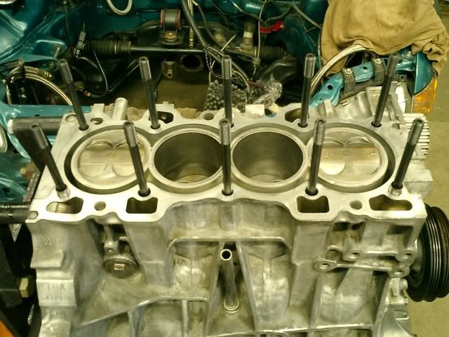

http://i197.photobucket.com/albums/aa271/shrekb18/CRX400.jpg?t=1232254979

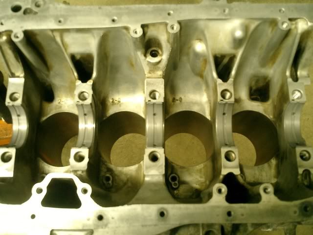

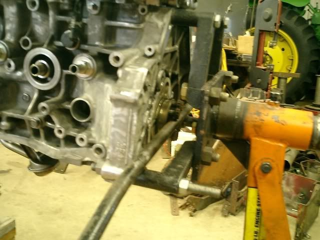

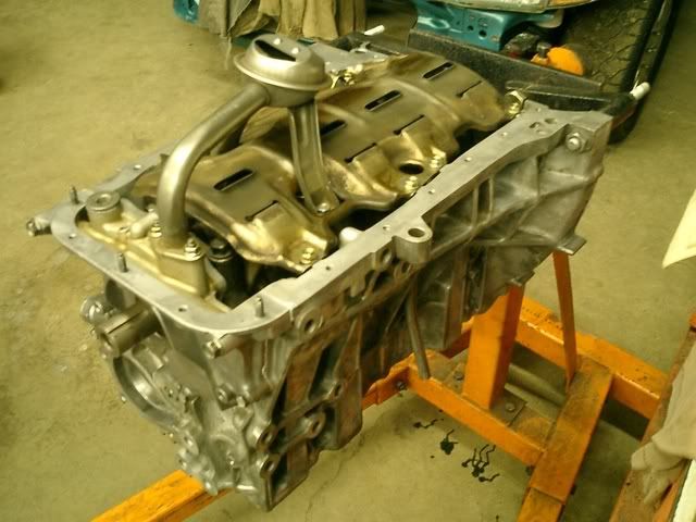

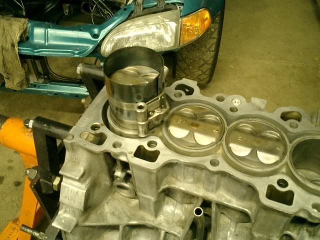

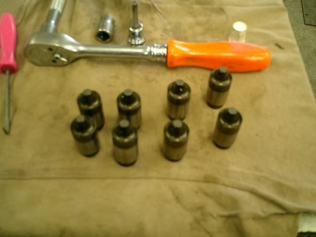

Got a lot done today. I have to weld the oil pan up, it had a hole from a turbo drain, Going to start cleaning up the intake manifold tomarrow, Need to order a inake gasket and some studs.

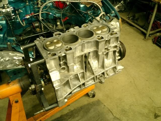

http://i197.photobucket.com/albums/aa271/shrekb18/CRX401.jpg?t=1232255047
http://i197.photobucket.com/albums/aa271/shrekb18/CRX402.jpg?t=1232255107
http://i197.photobucket.com/albums/aa271/shrekb18/CRX403.jpg?t=1232255218
http://i197.photobucket.com/albums/aa271/shrekb18/CRX404.jpg?t=1232255328
http://i197.photobucket.com/albums/aa271/shrekb18/CRX405.jpg?t=1232255634
http://i197.photobucket.com/albums/aa271/shrekb18/CRX406.jpg?t=1232255692
http://i197.photobucket.com/albums/aa271/shrekb18/CRX407.jpg?t=1232255741
http://i197.photobucket.com/albums/aa271/shrekb18/CRX408.jpg?t=1232255794
http://i197.photobucket.com/albums/aa271/shrekb18/CRX409.jpg?t=1232255838
http://i197.photobucket.com/albums/aa271/shrekb18/CRX410.jpg?t=1232255886
http://i197.photobucket.com/albums/aa271/shrekb18/CRX411.jpg?t=1232255934
http://i197.photobucket.com/albums/aa271/shrekb18/CRX412.jpg?t=1232255990

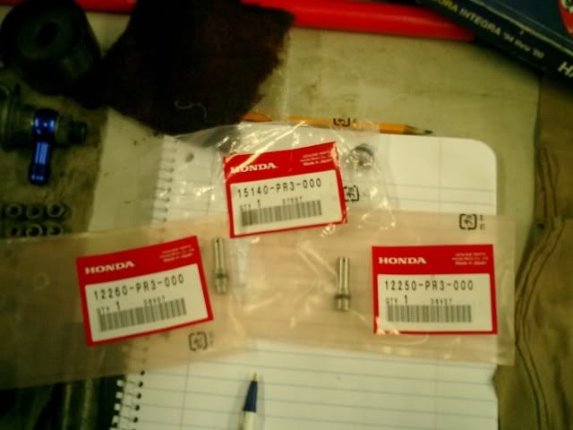

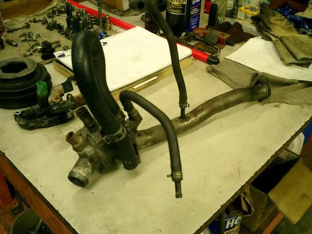

To be cleaned - Befor pic
http://i197.photobucket.com/albums/aa271/shrekb18/CRX413.jpg?t=1232256046
http://i197.photobucket.com/albums/aa271/shrekb18/CRX414.jpg?t=1232256118

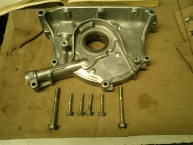

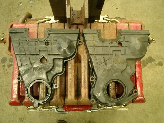

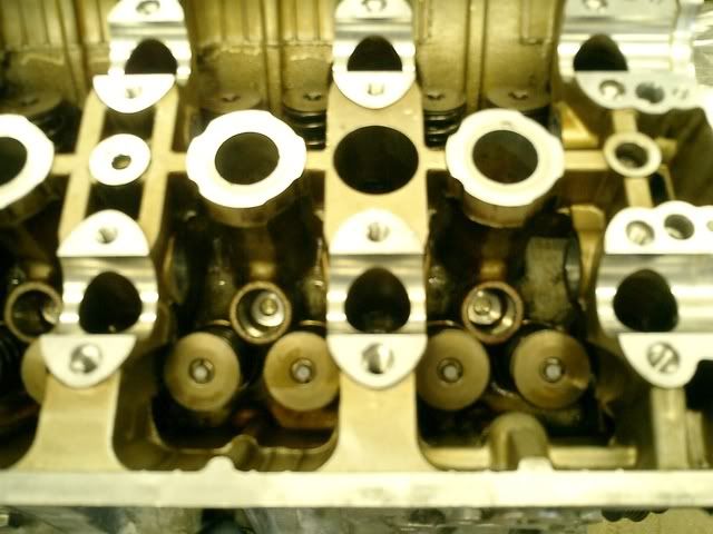

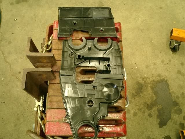

I had two outer covers, used the one on the left. The one on the right is for a LS
http://i197.photobucket.com/albums/aa271/shrekb18/CRX600.jpg?t=1232405714

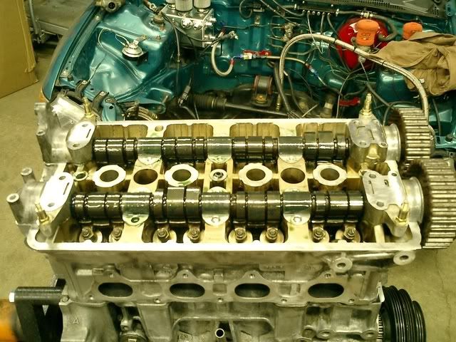

Here’s the cover I didn’t realized needed to go on before the cams… that sucked
http://i197.photobucket.com/albums/aa271/shrekb18/CRX601.jpg?t=1232405739

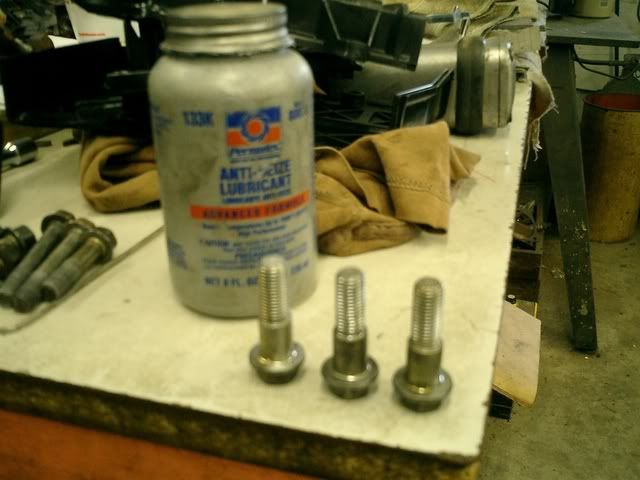

My trick to cleaning rusty bolts
http://i197.photobucket.com/albums/aa271/shrekb18/CRX602.jpg?t=1232405766
http://i197.photobucket.com/albums/aa271/shrekb18/CRX603.jpg?t=1232405788

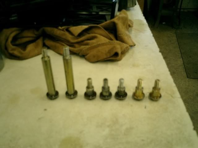

Cleaned up the 3 bolts for the intermediate shaft. I anti seize most bolts, installed so I don’t lose track off them

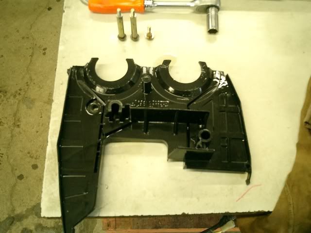

These are all the bolts that hold on the timing belt cover
http://i197.photobucket.com/albums/aa271/shrekb18/CRX605.jpg?t=1232405834
Covers cleaned

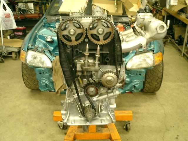

The second time I had to install the belt and align everything
http://i197.photobucket.com/albums/aa271/shrekb18/CRX608.jpg?t=1232405900
Torque the pulley 130ft lbs. used this pipe to hold the flywheel bolts

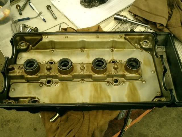

Installed the gaskets in the valve cover

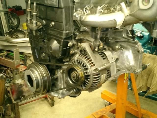

Alternator brackets and bolts
http://i197.photobucket.com/albums/aa271/shrekb18/CRX614.jpg?t=1232406061
Alternator installed
http://i197.photobucket.com/albums/aa271/shrekb18/CRX615.jpg?t=1232406081

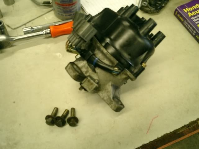

The distributor stills needs to be taken apart and cleaned but I gathered up the bolts clean them and install them to keep track.
http://i197.photobucket.com/albums/aa271/shrekb18/CRX616.jpg?t=1232406102

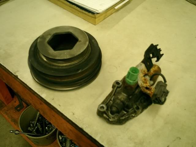

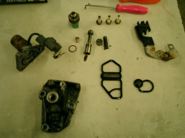

The last thing I did was take apart the vtec solenoid to be cleaned.
Still have parts to clean and go thru… I have to order a intake gasket and a freeze plug

that other bottom cover looks to be from a 96- up motor with the sensor
We can talk
I’v never had one of them, the LS has the CPS also
