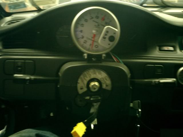

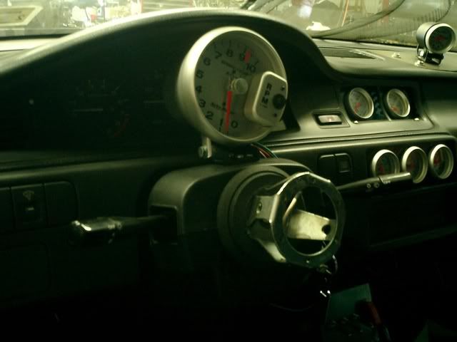

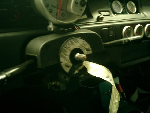

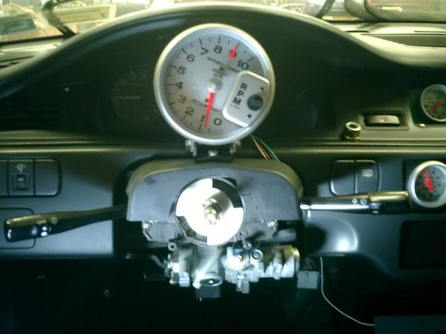

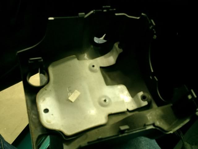

removed this plate
http://i197.photobucket.com/albums/aa271/shrekb18/SHK06.jpg?t=1234962341
http://i197.photobucket.com/albums/aa271/shrekb18/SHK04.jpg?t=1234962272
http://i197.photobucket.com/albums/aa271/shrekb18/SHK05.jpg?t=1234962308

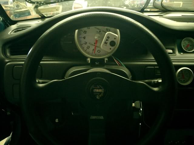

soo… how do u know how fast ur going lol
Well this wheel is smaller and blocks the tack, I only installed this tach b/c the stock one quit working. I found the loose wire so Ill probably remove it now. Who cares how fast your going? You mean in town… I can tell by gear and RPM’s
