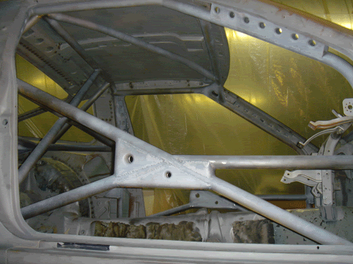

ok i found a pic of the sort of thing i’m refering to
now this what i mean by daily driven vs. track your not gonna drive that every day are you? this i s why i feel its more practical to do some sort of sea or stitch welding. now tell me if you were in an accident in that car without a helmet that there is not chance that your head will make contact. and this is aslo a properly engineered roll cage.

I would like to point out the fact that, that Cage setup is what appears to be a (10-12pt Setup) which is what is required when your Vehicle does like 11 seconds in a 1/4 mile run…
A Simple 4-6 pt or even 8pt Cage is NOTHING along that line and is alot more practical for a Road Application…
