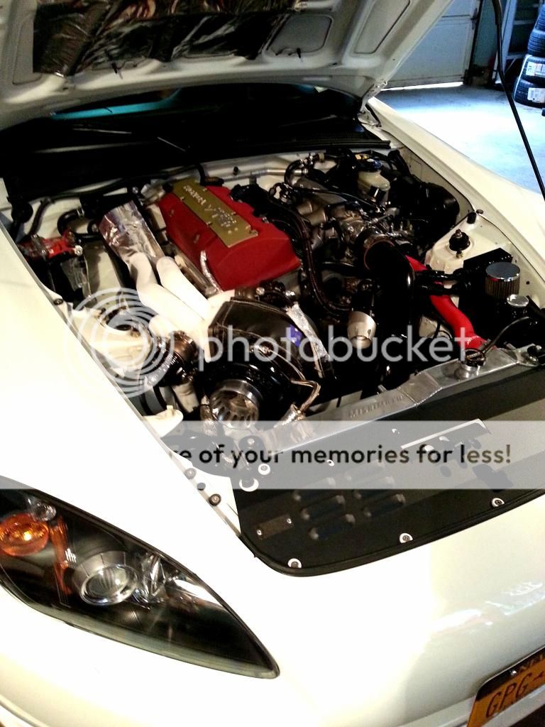

Got the car tuned over the weekend on E85.
Turbo S2000 Dyno IMW Carlisle Pa: http://youtu.be/bZdBnJ13Ic0 final numbers 603/400
And just on a bone stock motor
And just as reliable as a stock s2000, it’s all in the tuning!
Thats on a full stock motor?!
Nice numbers. What is your current setup?
2006 S2000 stock motor on E85
Flashpro
sheepey forward facing twinscroll
manifold and downpipe stm custom dump tubes all swaintech coated
Garrett GT3582R Divided Turbo t4 1.06
Tial 38mm mvs Wastegates
Mishimoto stealth Intercooler
Slim fan
Synapse BOV
PTP Turbo Blanket
ID1300cc Injectors
Aeromotive Fuel Pump
Fuelab regulator set to 55psi base
Hondata 4 bar map sensor
Hondata Boost Solenoid
Hondata Flashpro
Competition Clutch Stage 5 Clutch kit
Invidia Q300 Dual Exhaust
Invidia 70mm Test pipe
Sound performance boost actuated cutout starts opening at 5 psi (runs off downpipe)
Blueridge catch can
Shitty garage pic if how it sits now.
Nice numbers, how much boost?
10psi 1-3 , 19-20psi 4-6
