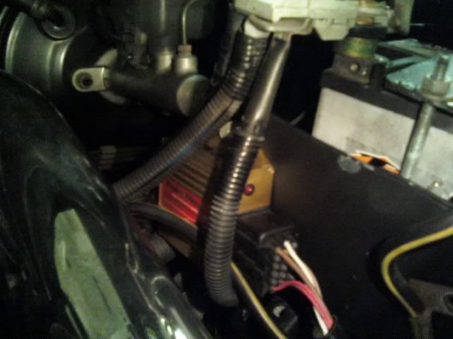

DLI is mounted and clipped in, Ive been sick this week so not much progress.
also that picture makes it look like a rats nest in there lol, its not.
