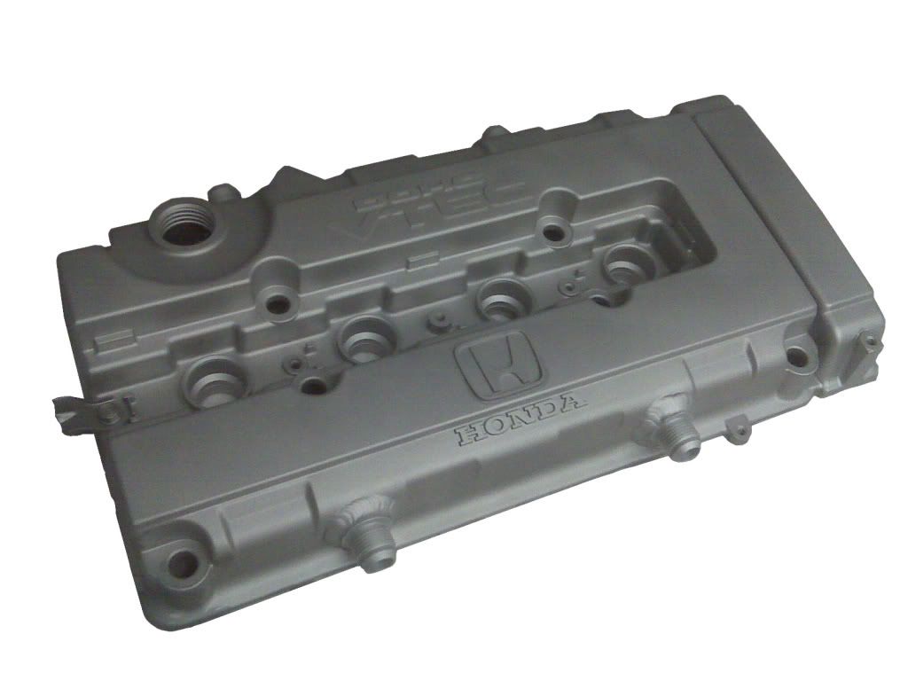

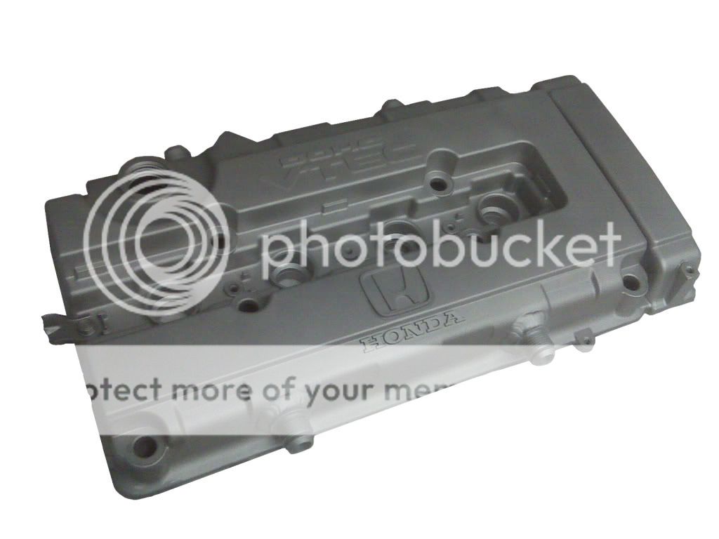

Catch can looks nice. The valve cover worries me:
There’s paint on all the threads, including those for the oil cap. Thread the cap in and out enough times and you will probably get paint in your oil.
Also, was the valve cover sand blasted to prep the surface before painting? If so, good luck getting the sand out of the internal baffling on the underside. Shake and blow it all you want…some will come out only when the valve cover is heat cycled. It goes into your oil, and smokes your engine.
You’ve made a costly mistake once already. I don’t want to see it happen again. Admittedly I hardly ever have a second to read this build thread so I haven’t read most of it, and there may be more that’s worrysome, but I read the last 2 pages and this stuck out.
Hopefully the valve cover was soda blasted for easy cleanup or something like that not likely to cause an issue.
Good luck!
ScSpeed
December 17, 2008, 5:39pm
555
Why not just vent from the block? There’s fittings they sell right from honda that take the place of the block plugs in the back of the block. This looks much cleaner and works more efficient as well. Thats what i did.
EDIT: Either way its a great idea to do it…Heres A few different ways that it can be done
SEE: http://www.honda-tech.com/showthread.php?t=1970101

ScSpeed:
SEE: Vented Valve Cover Post up some pics! - Honda-Tech - Honda Forum Discussion
actually its more efficient from the valve cover, the ports are bigger and its already baffled because placement on the front of the valve cover
2 -12an fittings off the valve cover should be more than sufficient as long as the can has big enough ports/filters
ScSpeed
December 17, 2008, 5:52pm
557
Thats true, i didnt think about the size dif. I was thinking about location. Either way its still a good idea to do…

Inn-Tune:
Good luck!
Vapor Blasted
ScSpeed:
4 to cover, 2 to block
http://www.t1raceparts.com/Block_plugs_p/b%20bp.htm
Performance - B-SERIES BLOCK PORT FITTINGS!!!! - B-Series Block Port Fittings 28mm to AN 10 Fittings with Aluminum Washer. $25 each, shipped. $45 shipped, for two. https://i210.photobucket.com/albums/bb161/bandrfittings/B-SeriesBlockPorts.jpg You can...

Shrek:
Very niceee. :tup: Can never have too much ventilation…
