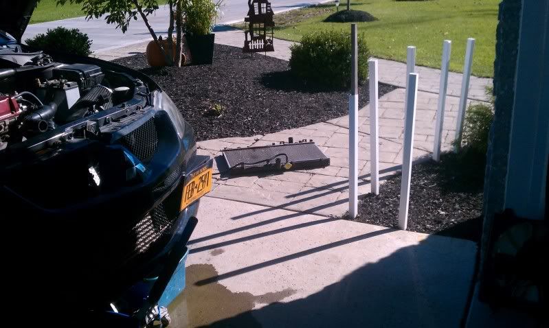

Got bored so I decided to tear my radiator out… Even though it’s still not here… Grr…

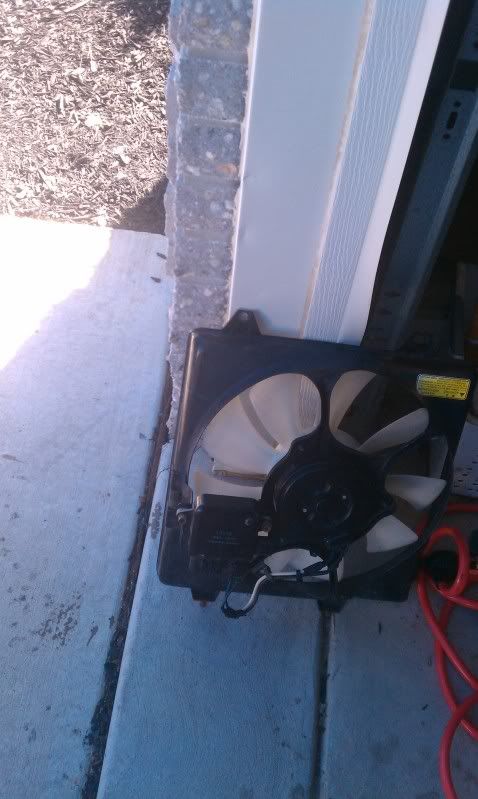

Fan out first… 2 10mm and a clip

I’m glad I pulled the radiator out when I did because I noticed a few problems.
Prior to this picture the wastegate actuator was rubbing against my o2 dump, this could have been giving me some knock problems. I loosened the bolts and pried it back a little. Evo’s have tight tolerances it seems.
I also noticed one of the AC lines was getting a little melted on the hotside of the intercooler. I ended up making a crude heat shield out of some electrical tape and aluminum sheet metal.
