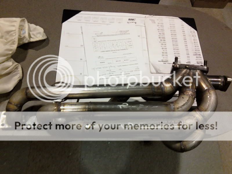

The charge piping will be rerouted but should be doable. its gunna need to go where the a/c used to be.
manifold is all set and ready to go. I just need to test fit it one more time to make sure everything is golden.
Looking good JD. Too bad I already seen it in person or I would be more enthusiastic. Is this one going to be more of a bitch to tighten down than the ssac manifold or not really because the turbo isn’t hanging downlow now. Running the oil drain and i/c piping are the next hard tasks. Where’s the bracing for the manifold?
That manifold looks so bad ass. I can’t wait to see more of it done.
I purposely positioned the runners for easy access but its still gunna be a bitch when i get closer to the collector. I need midget hands. oil drain will be close but be free and clear. also my silicone 90 will work, but i need to modify my hot side charge pipe obviously.
oh and as far as bracing goes, i will look into it but i have not seen any top mount or bottom mount tubular mani’s with bracing. Im almost positive the six runners will be more then strong enough. however if i can fit it i might just weld it on then. but i dont realy think its necessary.

John I was thinking about it that with all 6 runners it may hold together better than a 4cyl manifold but you still have a lot of weight being supported and the exhaust will be even longer now. Even if you didn’t weld braces in, but used some spherical rod ends and threaded bar to help support weight it may save the time of having to fix cracks in the future. Plus it will give you some baller status as no one else in the bmw world does it.
If you want I’ll get you some pics of dsm support setups. Here’s my talon’s header after jethot.
3 3/8ths ss rods for support.
http://img.photobucket.com/albums/v682/devioustsi/Talon/r100_2422.jpg
Oh and I sent you a pm for the heat sheilding.
^ sexay
I would brace it as well, just to be safe. Mr. Burch speaks the truth.
