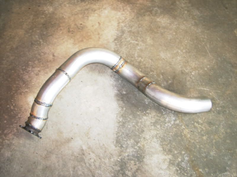

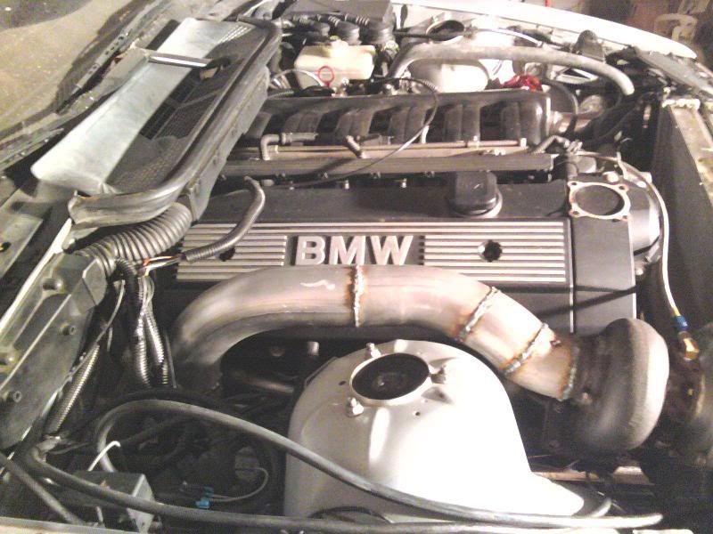

well, finally had some time so i started making the downpipe. this is very tricky and has a million different bends. PLease ignore the ugly welds, its been a while since ive actually had to weld something. either way its all getting wrapped in high temp heat wrap and the turbo is getting a blanket. Ill get better shots tommorow as i hope to be finishing up with mostly everything.:slight_smile:
Stop taking pics with your cell… how much room is there by the firewall/header?
enough, i decided to do some trimming on the smog pump tray so i wouldnt have to worry so much about room.

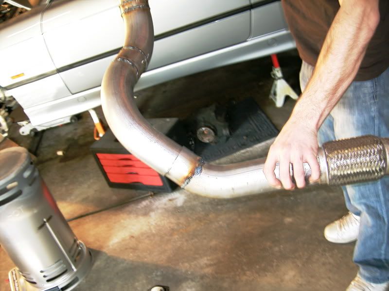

well, i finished up the down pipe and it wasnt fun. lotsa bends and kinda tough wind it into place but its done and it works. in 2 sections though.

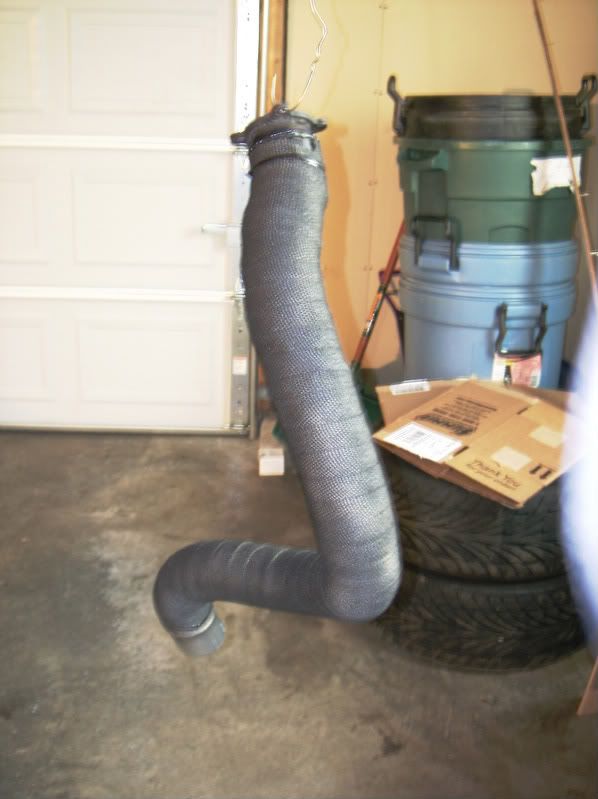

here is a picture of the downpipe wrapped and sprayed with high temp silicone paint.

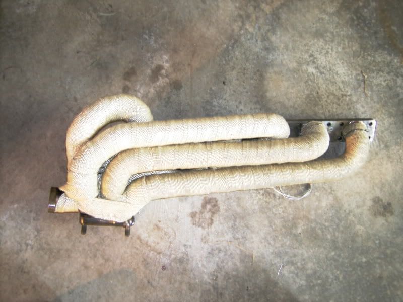

and a couple pics of the manifold wrapped. I couldnt get anything else done because i need to wait for the header wrap to dry.
ill put more pics up as i finish more little projects. Wrapping took longer then expected.:frowning:

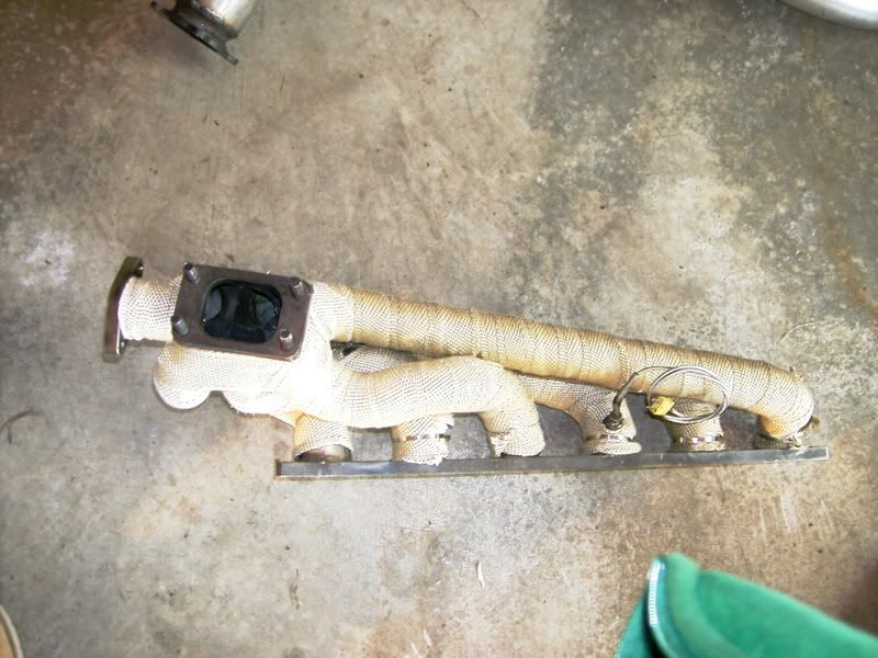

here is some more progress pics. Manifold is now coated with high temp silicone sealer. here are some pics of the manifold installed with downpipe.
