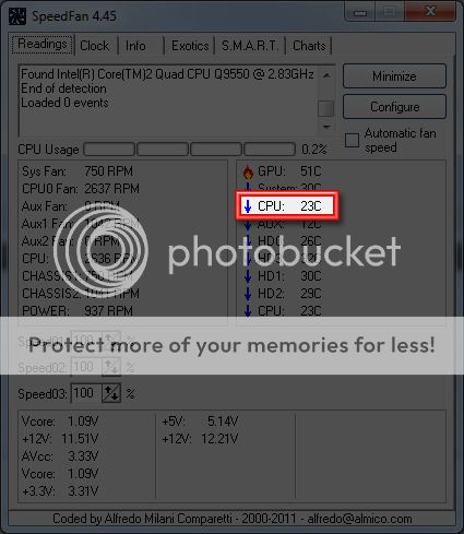

All my shit is air cooled, no specialness here. Why are you posting old CPUs anyway?
http://img.photobucket.com/albums/v398/Thorguitarist/c2f2593c.jpg

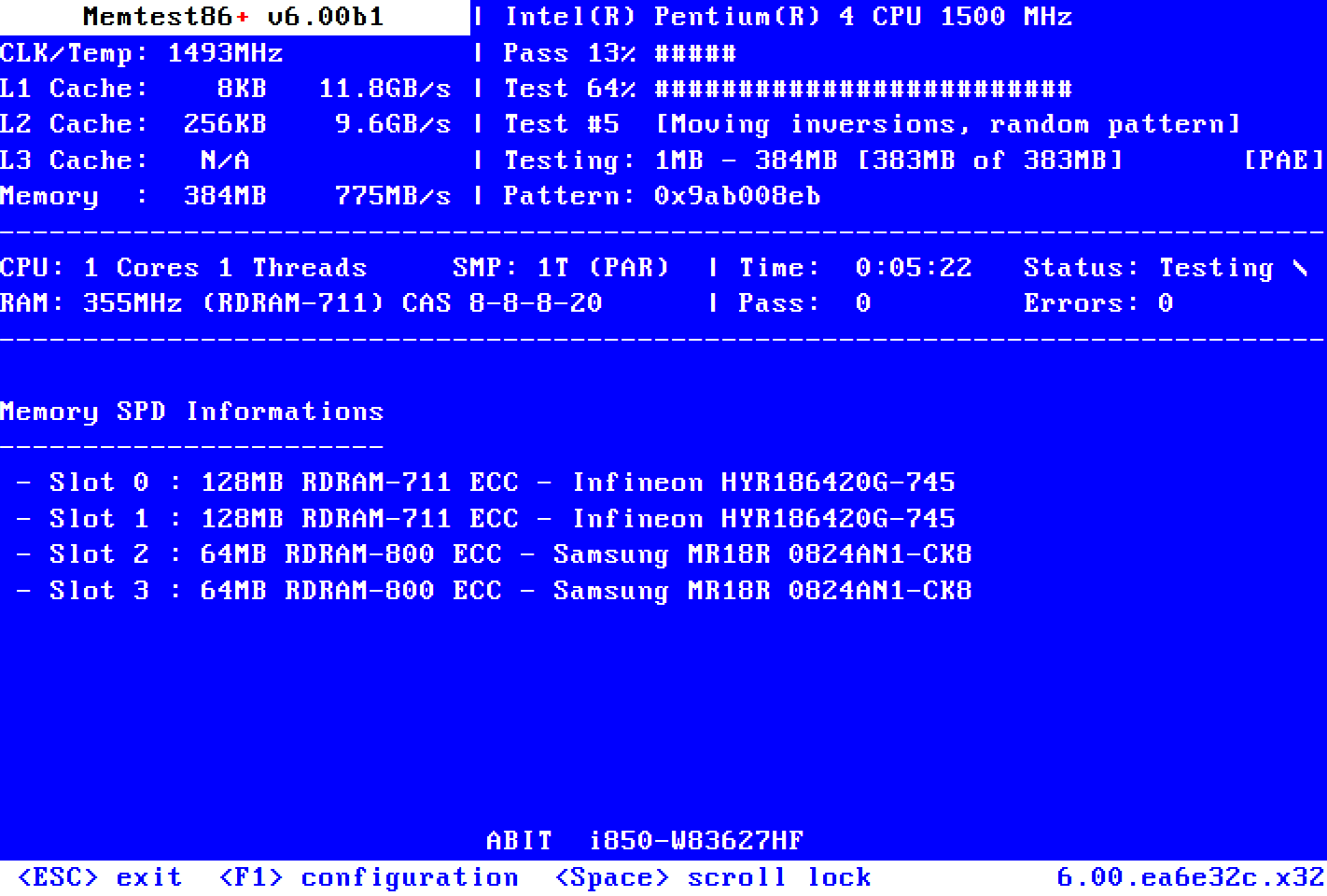

You clearly didn’t read anything I wrote. Memtest is a live CD so as long as the computer can boot to a disc, he can run memtest. Judging by the pictures he can boot to a CD. The only thing that requires windows to be installed was Sony Update, which I mentioned. I’m not sure if Sony allows for the BIOS to be updated via USB or CD. It’s not bloatware, it’s a great utility similar to Toshiba’s service station, HP’s Support Assistant, and Dell’s Support Center. It grabs updates to your PCs drivers and software from Sony rather than manually going and getting each one. If it’s “bloating” your PC, it’s probably time to upgrade.
