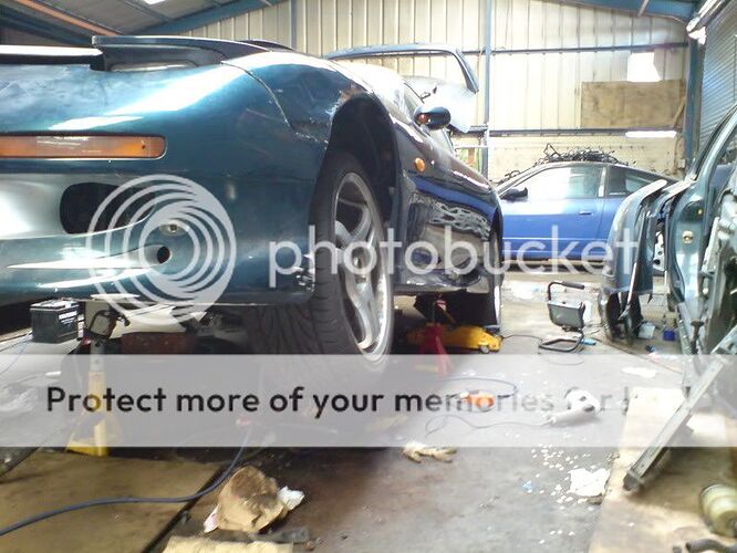

Took my silvia on the student gumball when on my way home this happend!! dont buy cheap rear tyres just because your going to kill them in a event. (should of stuck with my falkens but didnt want to ruin them)
wasnt hurt at all and no one else was involved.
then found this in Mr henners shed so i bit his hand off as i loved my old rx7.
thougth screw it be interesting totransfer the sr20det engine into the fd, ino ino its not a rx7 anymore but i want to just do it for fun and then after a year i will 20b it.
the Advans off the silvia fitted perfectly on the FD! and my steering wheel!

subframe and steering rack connected
put the engine in to day and the bonet hits the rocker cover so i need to make a vent/buldge
will now take the engine back out after ive made the Gearbox mount!

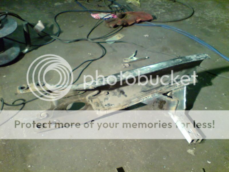

finished all the suspension arms !!
top mounts will be here friday
gear box mount and diff mount are bein made up at the moment

differential mount done today.
prop shaft only needs to be longer by12mm so im contemplating whether to make a spacer???
sprayed my welded mounts black to make them look a bit beter and protect from rust.

well i got stopped in my tracks!!! bit of a slight camber problem! need to make new custom lower arms!! that will be fun!!!

his mount designs aren’t too bad, but that’s what happens with a low amp welder. I need a nice 220v mig…
