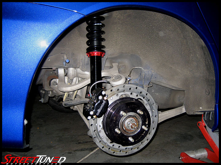

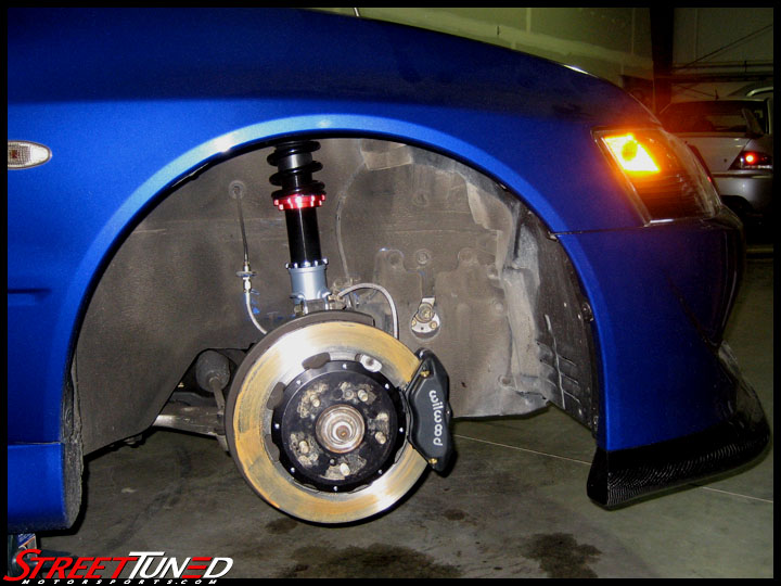

We have actually been slacking on the Ricer because of our new shop location, but things have settled down and we now have it here at our new place.

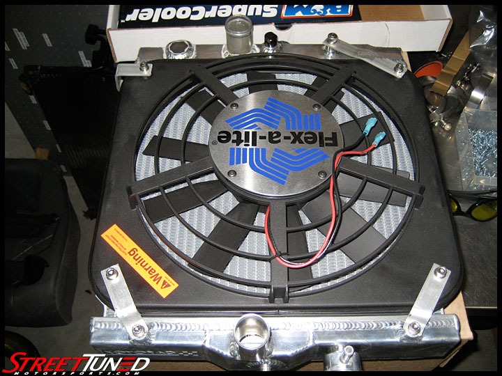

We have some things done- AMS’s small brake kit all around, megan coilovers, small Koyo and FAL fan, and a carbon lip. I would like to see a carbonfiber roof and hood, but we’ll see what the next few months hold.

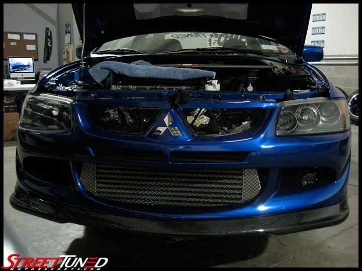

The engine bay is all tore apart waiting on a new 35R TiAL V-band set-up that STM will be fabricating {thumbup} That’s why we have the half-size radiator… that new set up is going to need some room!

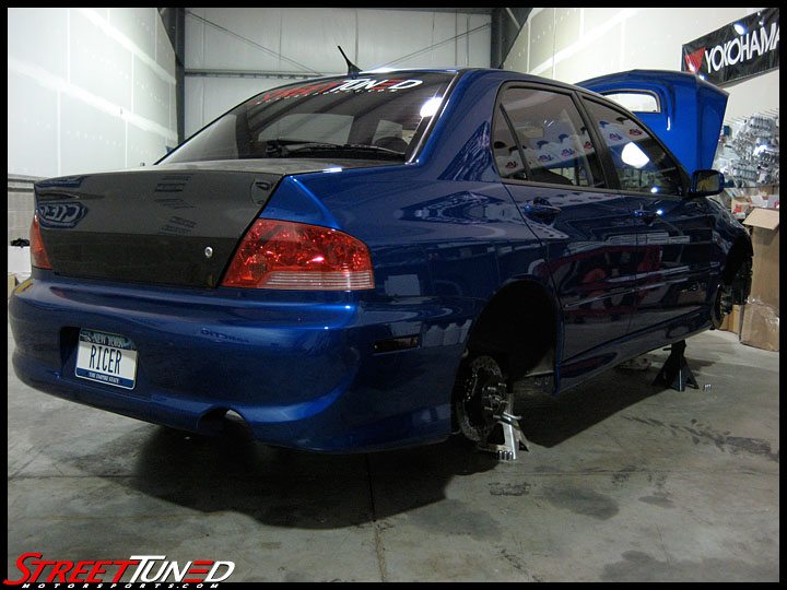

http://www.streettunedmotorsports.com/used/1ricer_progress/2-25_rear_jacks.jpg
http://www.streettunedmotorsports.com/used/1ricer_progress/2-25_brakes_front.jpg
http://www.streettunedmotorsports.com/used/1ricer_progress/2-25_brakes_rear.jpg

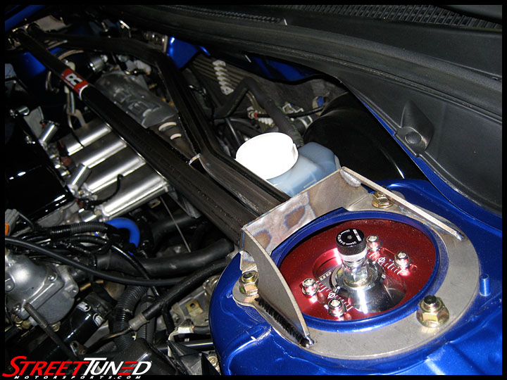

http://www.streettunedmotorsports.com/used/1ricer_progress/2-25_strut.jpg
http://www.streettunedmotorsports.com/used/1ricer_progress/2-25_small_koyo.jpg
http://www.streettunedmotorsports.com/used/1ricer_progress/2-25_front_lip.jpg

omg, smaller brakes!
How do they feel?
This car has been up on jacks since November, but they felt good when we were bleeding them!
unless the compound is different they should feel pretty much the same… size just help prevent fade… more pots can help with feel and even pad wear. how a pad bites really just depends on compound and if a pad is in its happy temp range.
I love evo’s with little wheels and slicks… they look so evil:
:tup:
It was mainly for the weight difference… and of course the smaller wheels required to run slicks won’t fit over the big-ass Brembo’s!
I’m not good with numbers, but I’m sure Emery remembers exactly how much was shaved between the brakes and Coilovers.
probably something like 30 lbs. of static, and 30lbs. of rotational…
just about 30 of rotational and about 75 so far in static with alot more to come! New exhaust should weigh in at about 4lbs with muffler
so its going to be a 3.5lb. muffler and a .5lb. turn-down? lol
muffler is 1.1 lbs
-Em

Are you not all there? I do not road race the car and the new brakes shave 32lbs off the front of the car and 22lbs off the rear, the majority off that is rotating mass. Why and how would lexan windows benefit me more. And yes this car will be driven on the street also.

PPS - why do you have a strut tower bar if you’re trying to save weight, and don’t road race?
