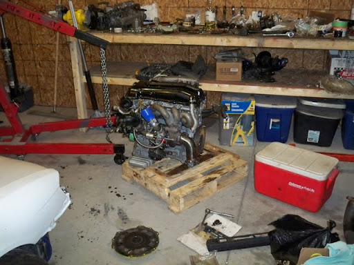

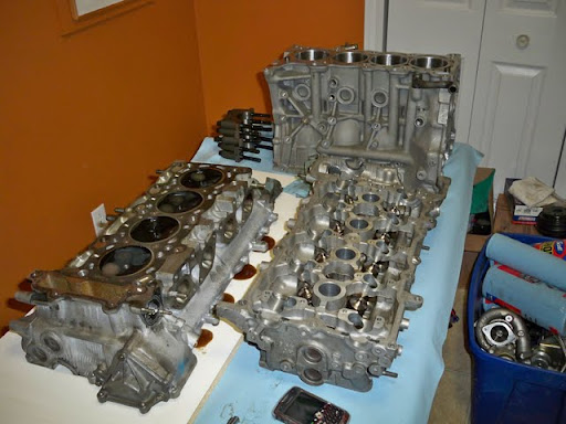

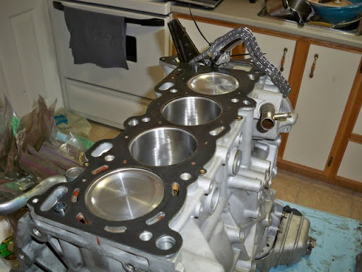

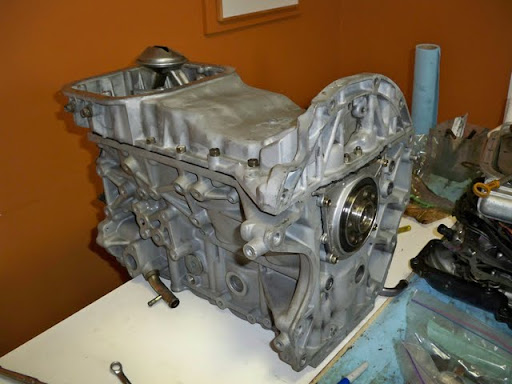

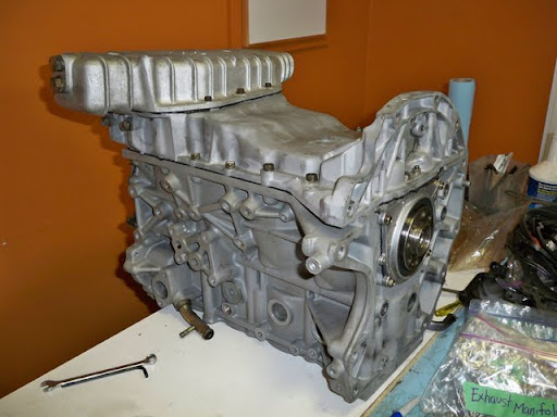

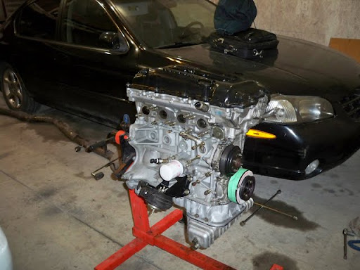

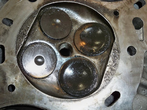

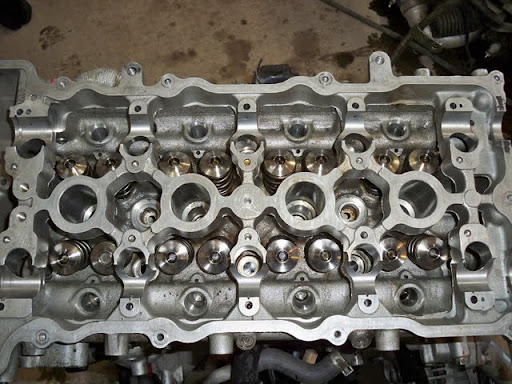

At this point, both engines are in pieces in the garage, and I don’t know when I’ll attempt to put them back together.  It looks like I can use the head from the new engine with the re-bored block from the old engine, but I still need to get rebuild parts and deck/clean up the new head.

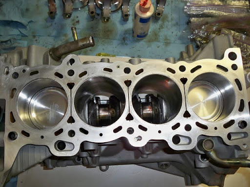

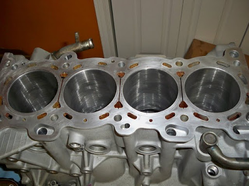

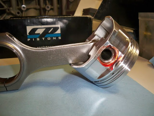

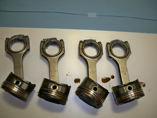

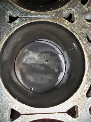

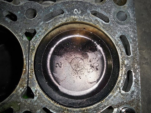

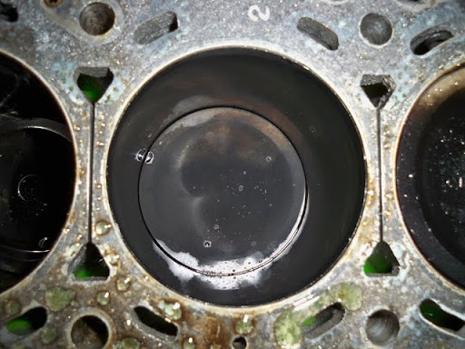

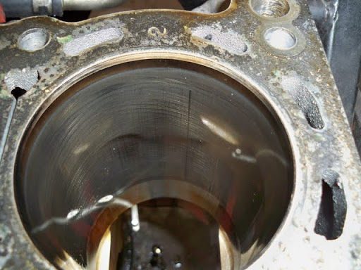

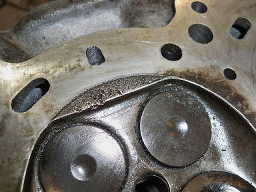

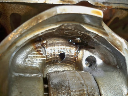

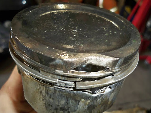

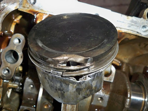

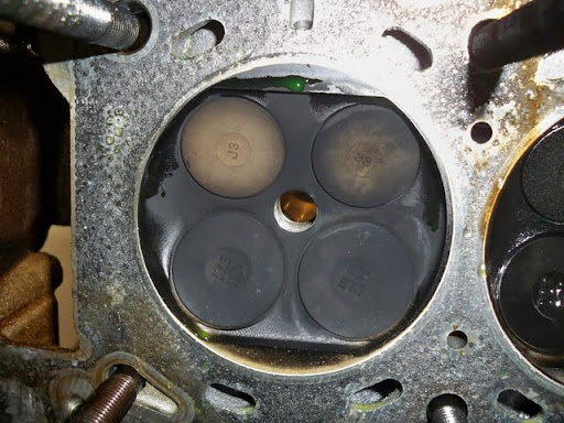

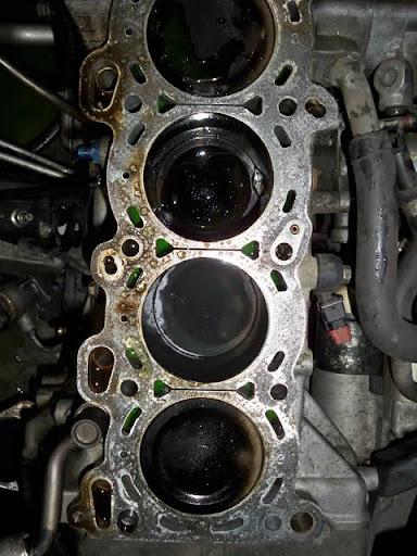

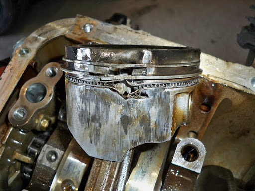

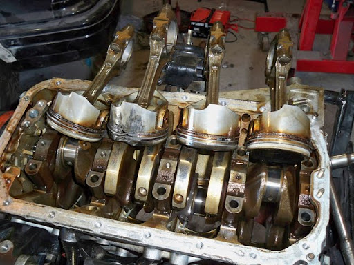

The damage was as follows:
- Piston #2 actually melted through the top and side
- Piston #3 cracked ring land

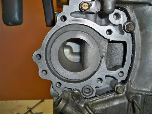

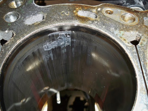

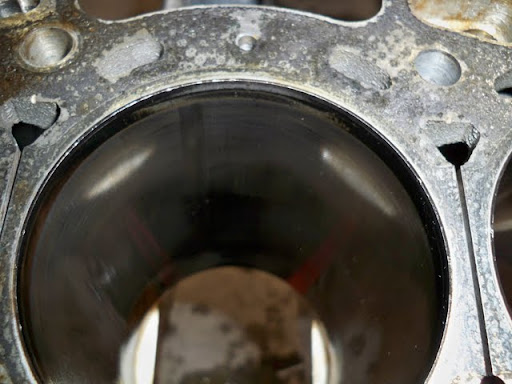

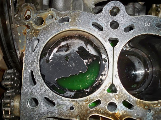

- Cylinder #2 aluminum build up and scoring on the wall
Compression test:
#1 - 133.5
#2 - 0.0
#3 - 91.5
#4 - 136.0

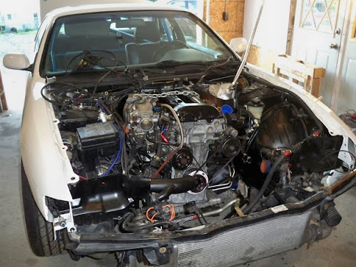

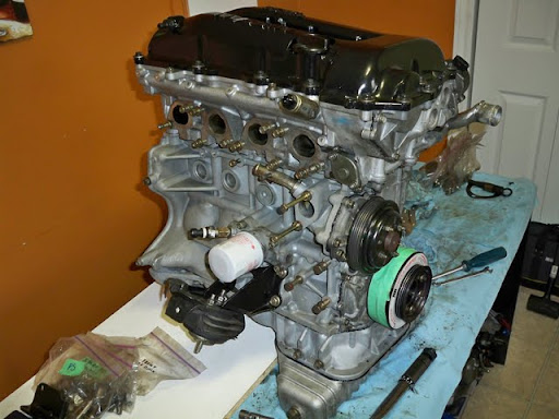

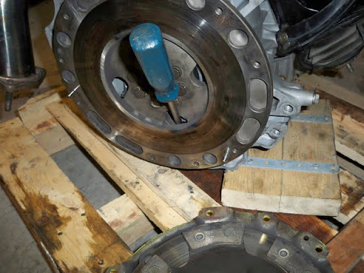

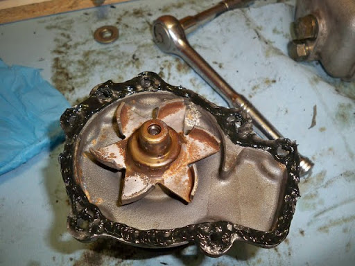

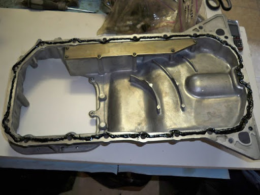

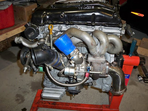

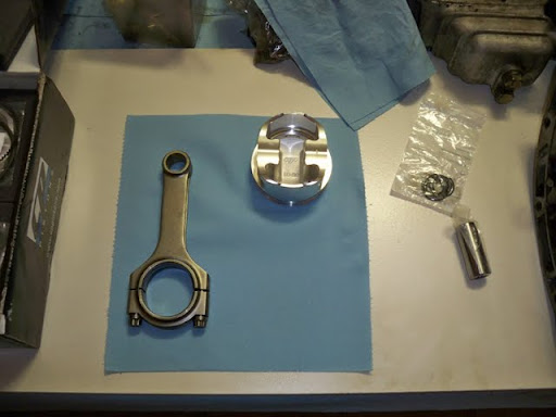

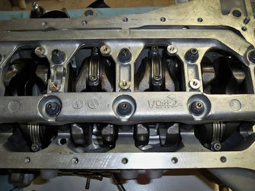

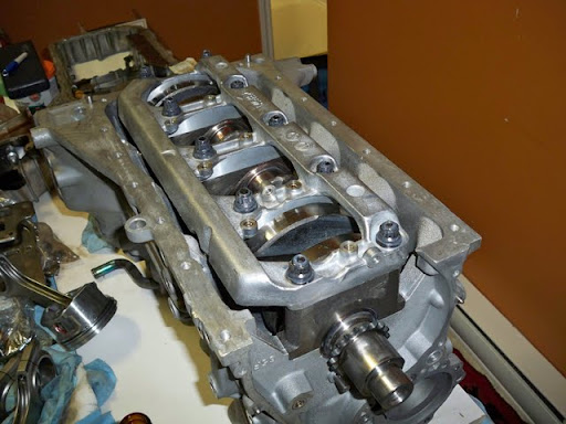

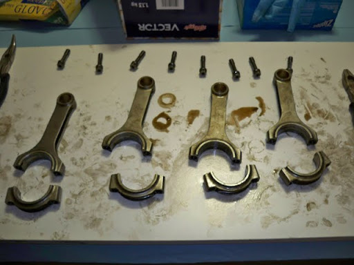

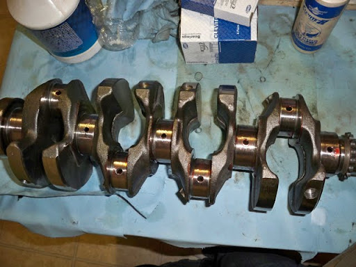

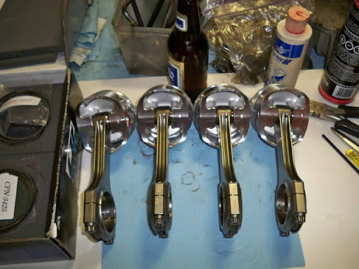

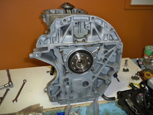

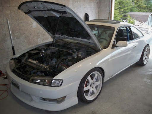

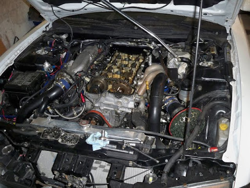

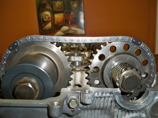

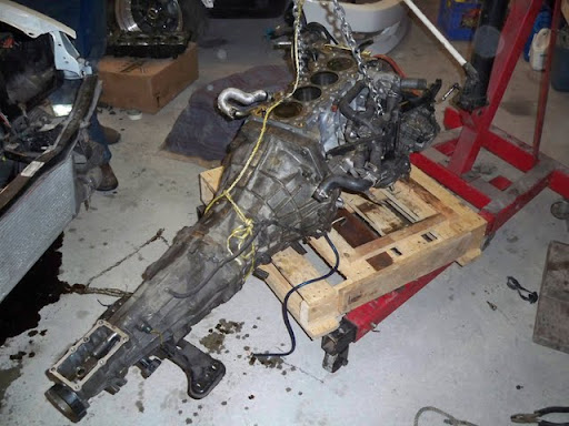

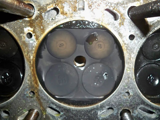

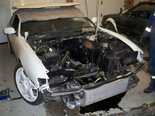

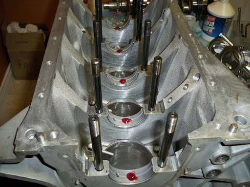

Here are the pics.

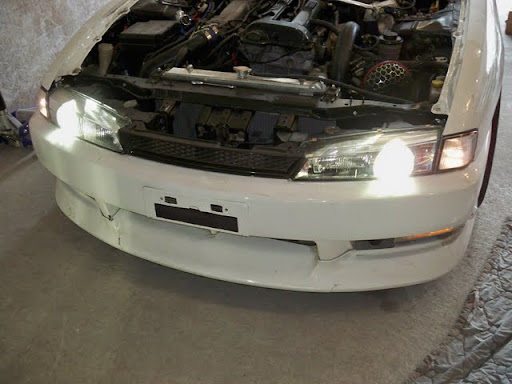

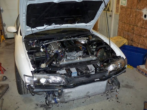

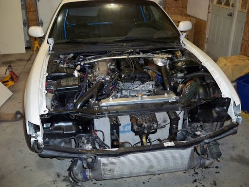

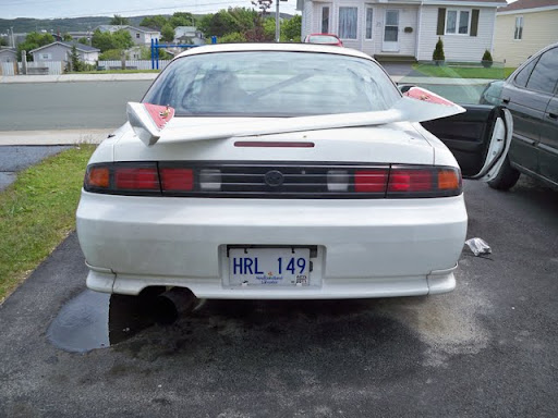

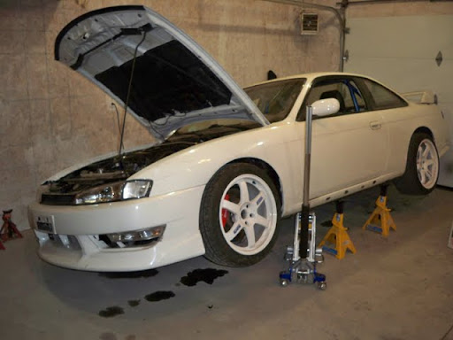

Shots still in the car.

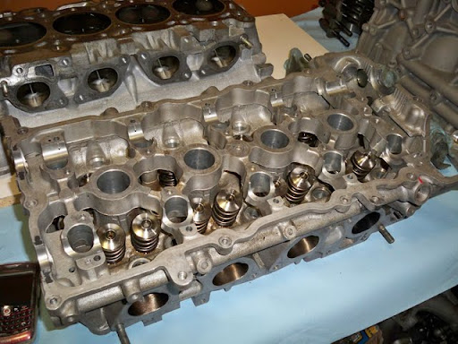

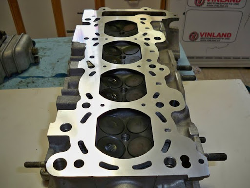

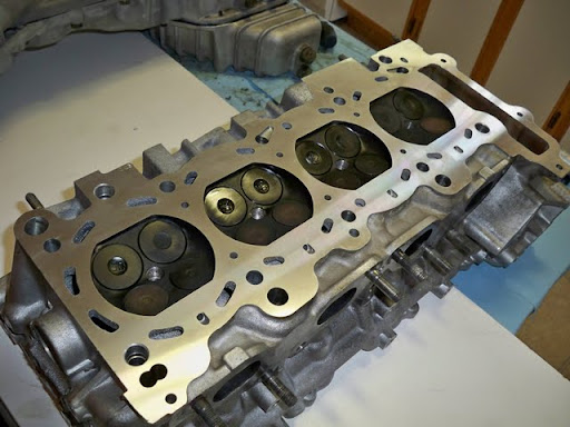

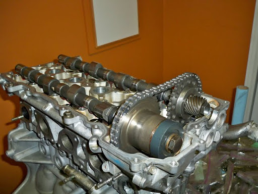

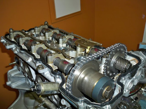

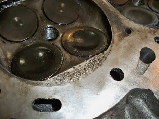

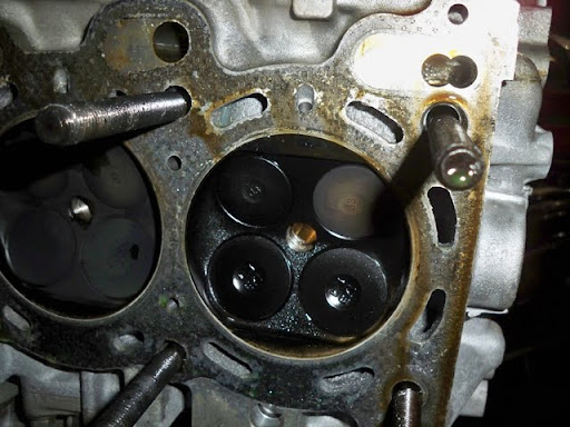

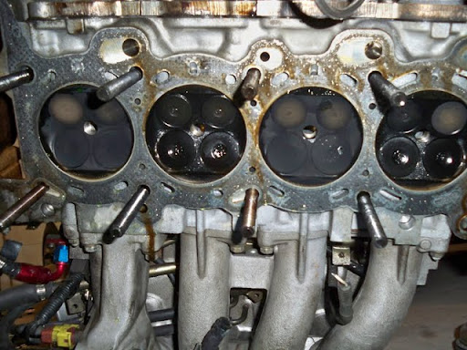

Head.

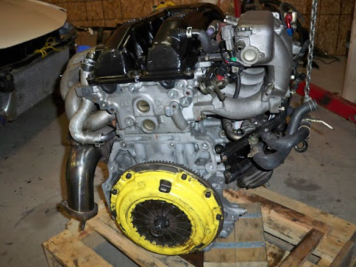

Pulled out.

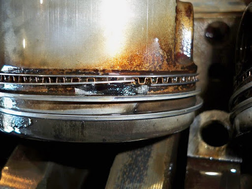

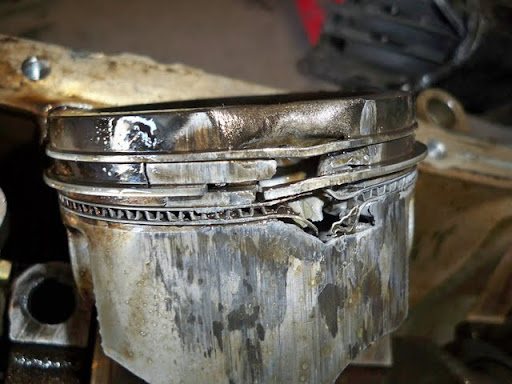

And the money shots.

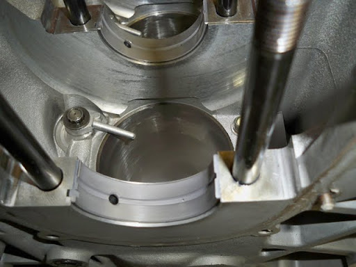

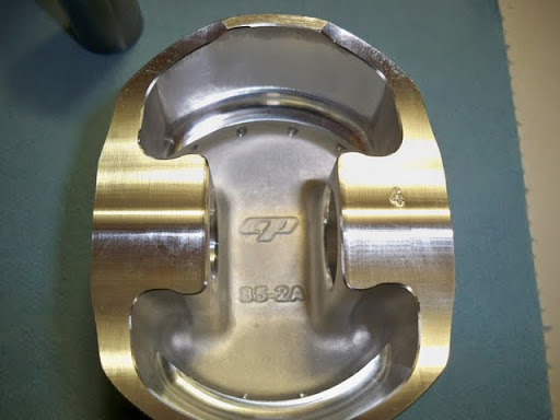

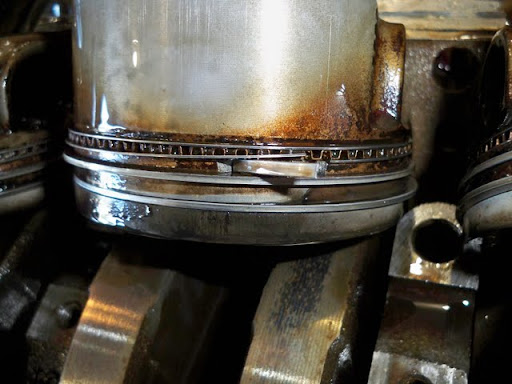

Note that after it failed, I was stranded about 10km from my house, so I decided to limp it home as is, as I knew that it was catastrophic (White smoke, no power, blown out dip stick).  The piston is probably more mangled from the limp home than it was when it broke, but you get the idea.
#2
#3

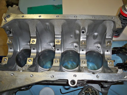

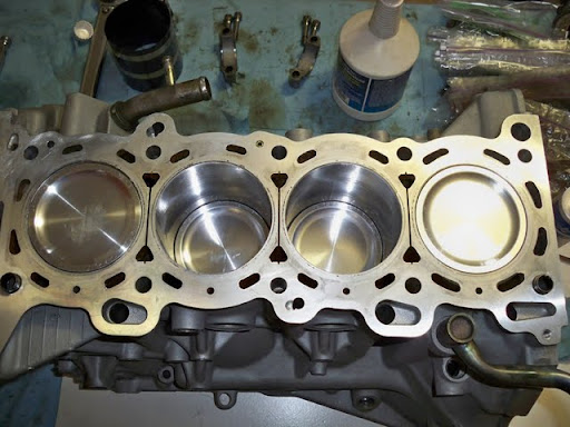

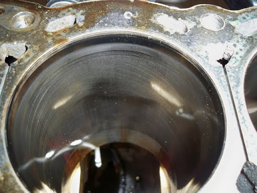

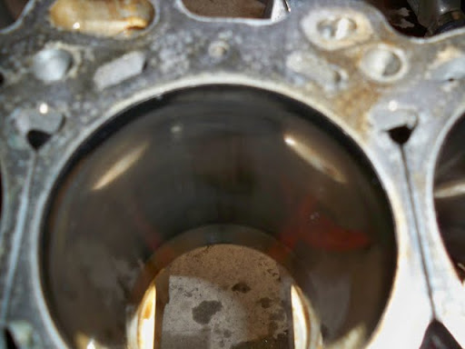

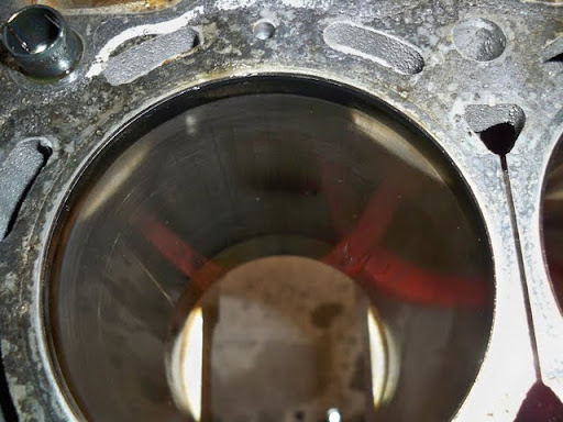

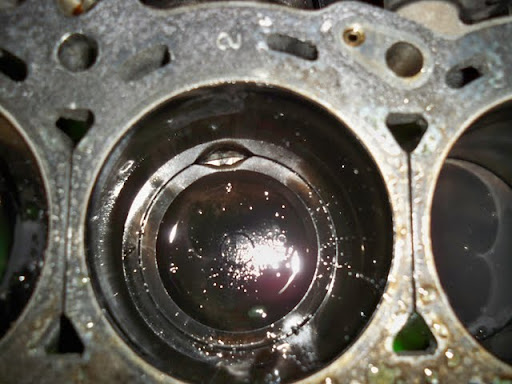

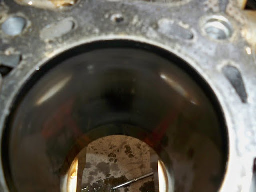

These are shots from both sides of each cylinder.
#1
#2
#3
#4

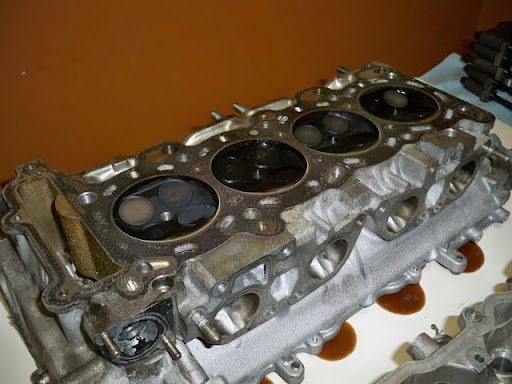

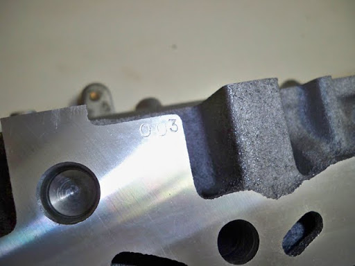

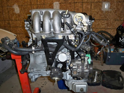

“Old” Head.
