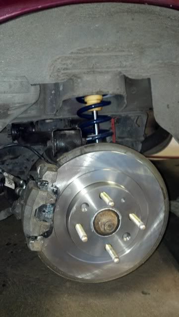

I initially ordered rotor’s from napa. The rears (pn 4886129) were the wong bolt pattern (maybe 4x114?) just for the record for anyone looking at NAPA rotors. Had to go to advance instead since NAPA had nothing else.

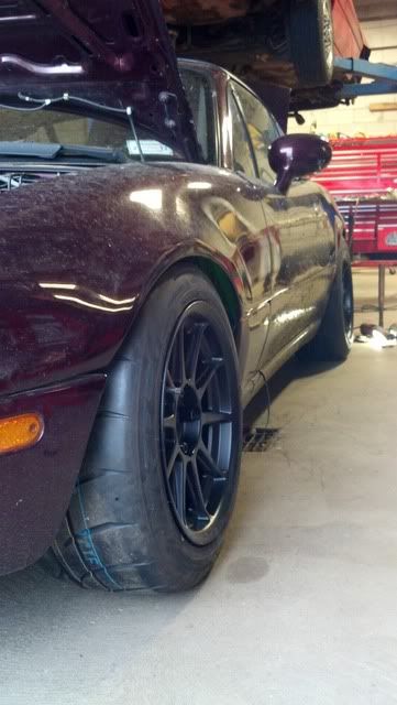

Rear brakes are done. Ride height is roughed in.
About to give her a bath. Shes filthy.

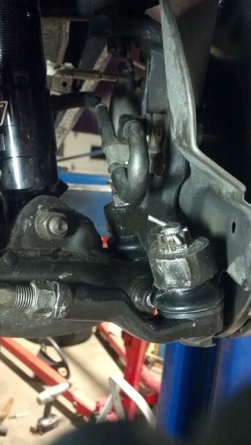

Replace the balljoints and tierod ends with OEM parts (r-edition tierod ends). The boots were cracked in the balljoints. All just preventative maintenance.
