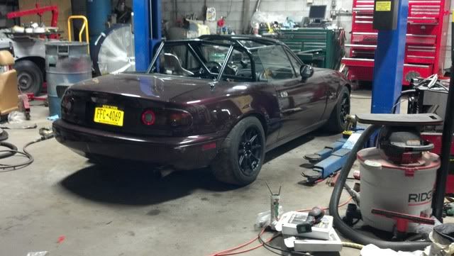

I have been chasing a phantom electrical issue that prevented the gauge cluster from working. Turns out there was a plug that was disconnected in the pass side far right under the dash. It was sorta hung up on the dashbar so I never even saw it. Plugged it in and everything is back to normal. Nice and simple.
Car looks like its on life support. Lol.

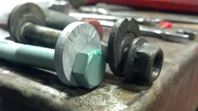

Buttoning up the odds and ends. Got all new eccentrics installed because the OEM ones were concave-- way cheaper to replace eccentrics than to pay for a new alignment if this one got knocked out of whack. Kinda hard to see in this pic but you get the idea. The newer version has thicker “washers” if you will.

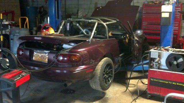

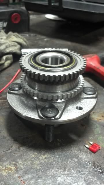

I ordered raybestos hubs and of course they came with the wrong ABS ring. I am 99% sure timken stopped making abs hubs (pn 513155)-- they are not available anywhere except ebay. OEM hubs are 140 a piece. Luckly, the old ABS rings fit on the new hubs perfectly. The more rings the better…right? Hubs were repacked with amsoil grease.

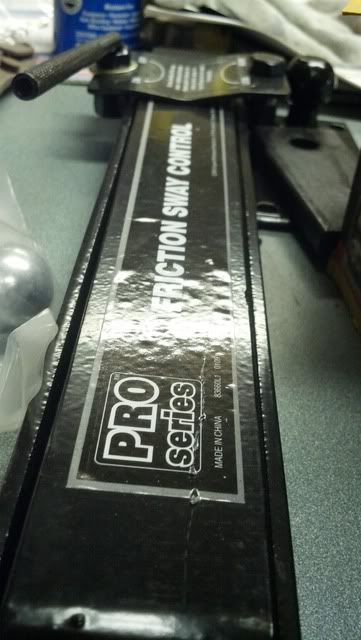

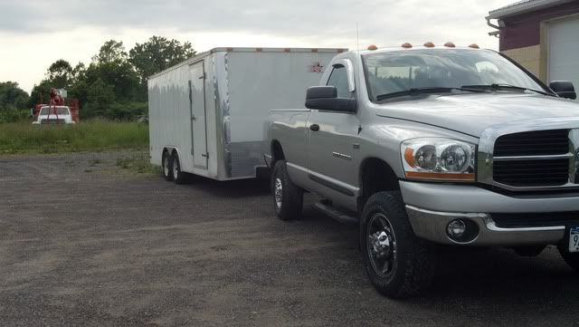

Started getting the tow vehicle ready today. Got a friction sway control thing to make the trailer more stable at high speed.
The tow package.

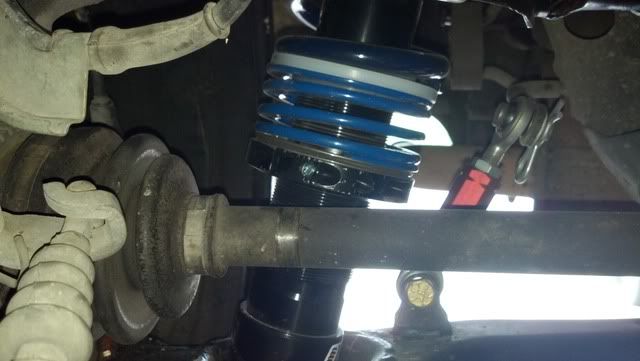

I think I figured out what the phantom noise is during hard cornering. The axle appears to be actually making contact with the height adjustment ring on the shock body. Identical markings on both sides. Ive never seen this being an issue before-- not quite sure why its happening on my car.

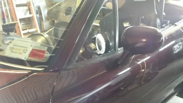

Installed a duct on the driver side. Hopefully it will get some more air into the cabin.

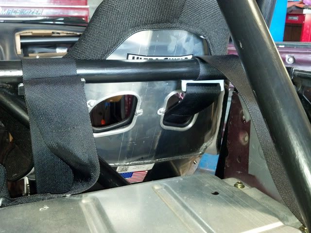

Trying to get the passenger seat in a better location. I dont think its going to happen. Without the relief bend in the crossbar, the pass seat just sits in an awkward position, causing you to bash your fucking head on the rollbar when you go over bumps. I cant mount the seat lower due to harness angle, so I think my only option is to add another crossbar to mount the pass side harnesses to. This is mounted at its lowest position.

Yeah like it was mentioned previously, it did not look like the cage was meant to have a pass seat installed just by the look of the harness bar. That can easily be changed though without too much trouble.
I think the issue is that most people blow out the seat belt towers to put in the “harness bar”. The seat fits, you just cant get the correct angle for the harnesses on the pass side due to the height of the bar. I need to figure out a way to bottom mount the seat. I am currently side mounting it-- I think bottom mounting it would allow it to sit way closer to the tranny tunnel. I think that would give enough clearance between your head and the bar so it wouldnt be as much of an issue. Its not really an option to add a seat relief to that side of the cage because the seat would still just hit the diagonal bar.
