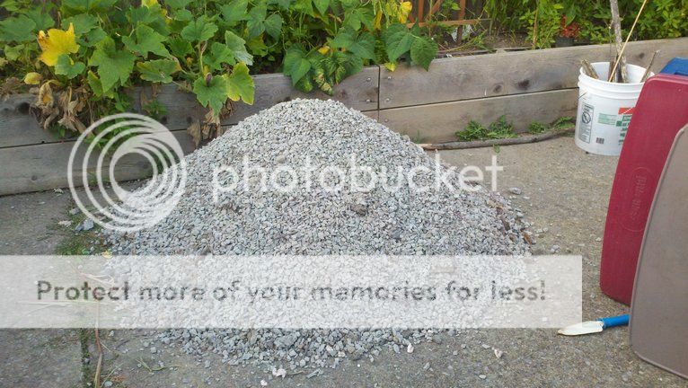

bought some stuff

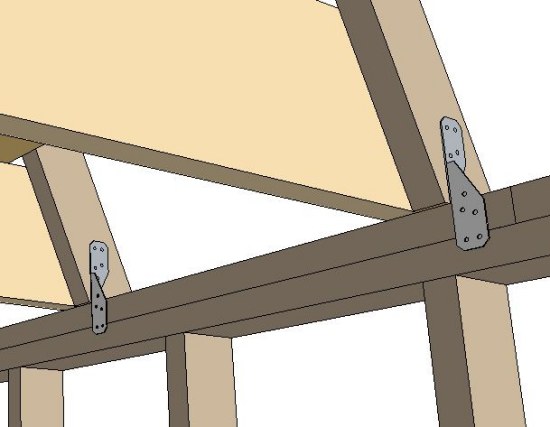

Put up my hurricane ties

Hurricane straps are supposed to tie the rafters to the top of the wall plate. You were close though. The drainage trench you speak of is available at Lowe’s. Just used one on my driveway. See my thread.
:slight_smile:
They would not prevent my studs from pulling way from the top plate if I installed them properly.
When I decide to fix the bowed rafters, I will probably use steel supports properly.
No job is complete unless I have had to redo it once or twice.
I was wondering how they would help hold a roof on based on the picture.
http://www.shedking.net/image-files/hurricane-fastener-1.jpg
Though I’ve also seen this:
http://www.floridadisaster.org/hrg/images/walls/wood_frame_roof_to_wall_straps_large.jpg
If you ask me though that’s just asking for a storm to lift your whole house up like in The Wizard of Oz.
