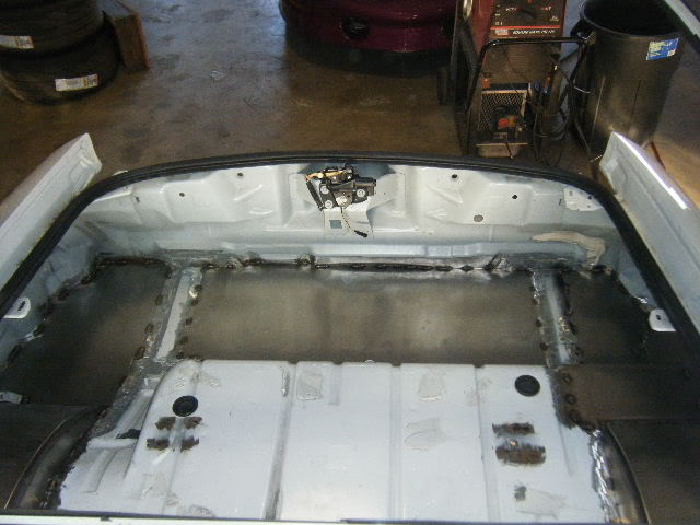

With the lack of actual room to cut things opened up the wheel well a little and now working on getting it matched up to the tub I forgot to grab more pictures only have the starting one.

So dynamat is the worst thing on the planet most of it is gone now just need to come back and remove residue.

Getting there still need to cut in a bit more but you’re cutting into 2-5 layers of metal at some points so its easier to go a little bit at a time.

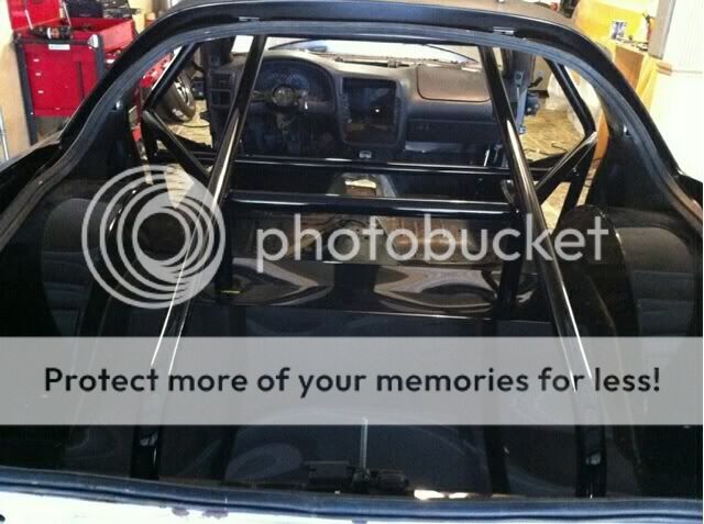

And cage is currently in the process of going in :tup:
