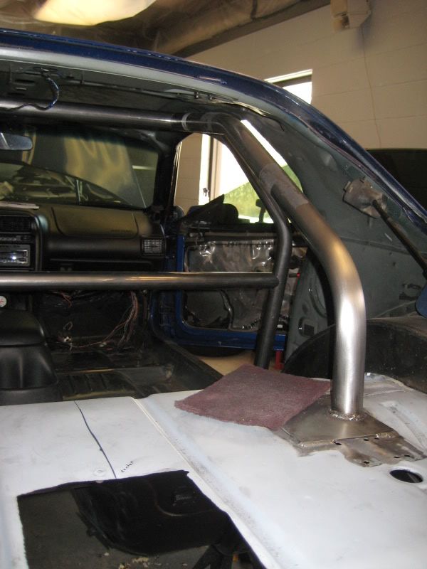

well today we were putting the 6pt in. i will still say the “layout” and “design” of the roll bar is very nice, as is the fit and finish.
unfortunately, the popular final resting place of the main hoop is WAYYY too close to my head. it amazes me that people actually drive around in the street with the bar this close to their head. if i were to be rear-ended, i would without a doubt become some sort of vegetable. my corbeaus aren’t helping either, being about 1" higher than stock, but still not the main problem. (i tried with stock and corbeaus) the bar is way too close to my head both horizontally and vertically. i could probably get away with it in a tense racing position with the seat upright and legs at 90*, but for relaxed street driving, :picard:
right now im just whipped, so ill get back on this another day. the bar needs to come wayyyy back, and even at that it will never be high enough. i would need kirkeys. its pretty rediculous considering im 6’, not exactly andre the giant
How much head to roof room do you have in your normal sitting position? How big is the tubing you’re using?
do they make a lower prof seat rail for your seats? but idk i had trouble seeing to the front of the hood and im like 6"1ish.
pics?
lol its impossible seeing to the front of the hood in these cars.
what i dont understand is, the bar needs to be over your helmet. in my stock seats, when i had my helmet on, i would need to crouch in my seats in order for my head to fit. these are the only rails available for my seats unless i make some. like i said, that isn’t the main issue here.
normal (relaxed) seating position, if i lean back and stretch my neck towards the bar, my head has no problem clipping the bar
Ah i see, what about slighly sliding the seat up, or would that make the car even more unfortable to drive?i cant actually picture what the cage looks like lol
Can you move the back back and still pass a tech at the track?
no good. i slide it up one click for racing position. anything more and im bound up. i go back 1-2 clicks for street driving, depending on the day… i wont give up comfort and safety for ability to run at the track and “safety”. i will scrap the track idea as fast as you can say go if this is a big problem, but i dont see why i can’t make it work. its just a PITA because this was a part of the build that was only a days work… now its going to be a couple :meh:
i can move it back. its going to be a PITA, but thats not the major problem. the larger problem is vertically. if tech were to come out with a ruler, it would ultimately become nearly impossible to legally pass tech the way the hoop is vertically. even at that, if it did, my main concern if for street driving. this is a STREET CAR which i drive all the time. i drive it too/from the office every nice day. i like my head withOUT a 1 5/8" dent in it

the no-good mock up:
(only thing i fully welded was the back bars on the base. came out cleanly with a cut off wheel. i was certain the bar was properly placed. oh well NBD)

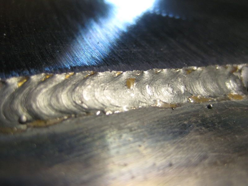

…im almost happy i had to remove the back bars because i was not happy with my welds. i am so not used to the smaller welder. with my 220 welders in the big shop, i can make these welds perfect… well anyways…
welding on the plates…meh

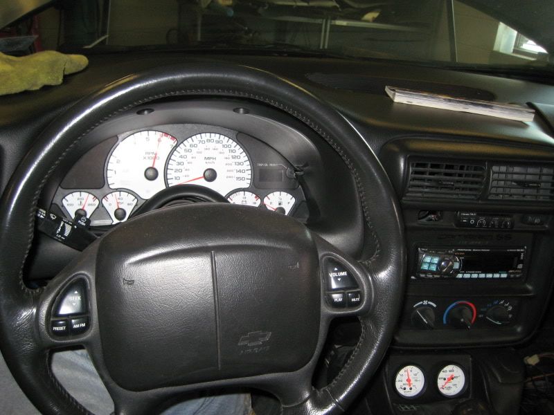

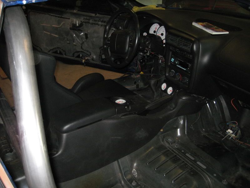

some interior shots with the new toys. kinda pissed because the flash from the camera really highlights the imperfections… it looks clean and dark when you see it in person

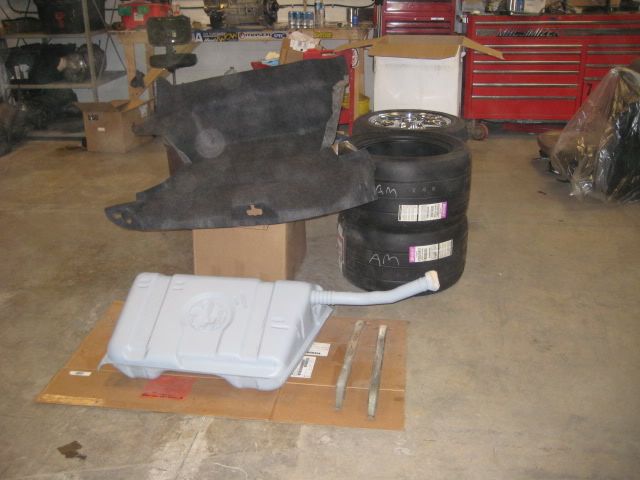

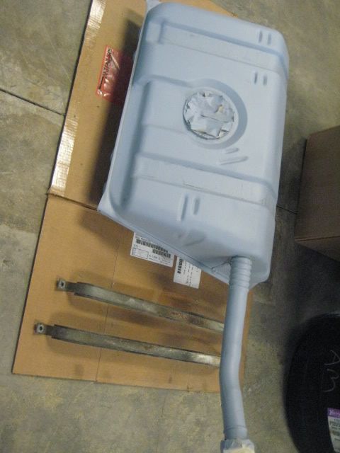

primered the gas tank the other day. thanks to JT76 and jen for sanding it up for me :tup:
starting another parts pile. i need to ditch some of the stuff on my shelves and reorganize.
