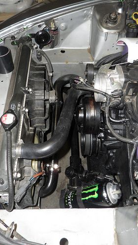

electronic rack :confused: can’t do nothing about it lol. it just plugs in and the rack is there
drivers side

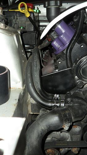

http://i287.photobucket.com/albums/ll148/95LS1t/8351017953_e4791dc575_zpsea4fedce.jpg

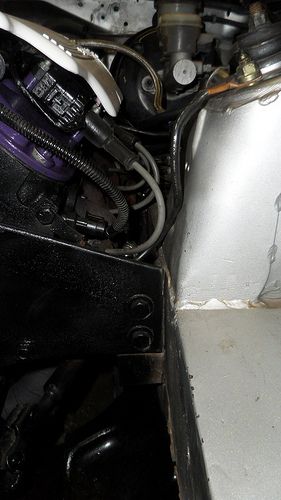

pass side
http://i287.photobucket.com/albums/ll148/95LS1t/8351018939_0e9469d92c_zps74429938.jpg

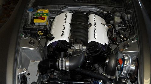

front of motor
http://i287.photobucket.com/albums/ll148/95LS1t/8350819436_e150fc5405_zps744ced59.jpg
if it fits on the right, it should fit on the left ! if only i could sneak a pipe past the what looks like valve covers
