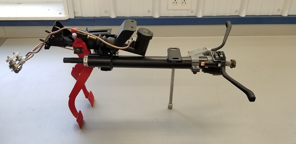

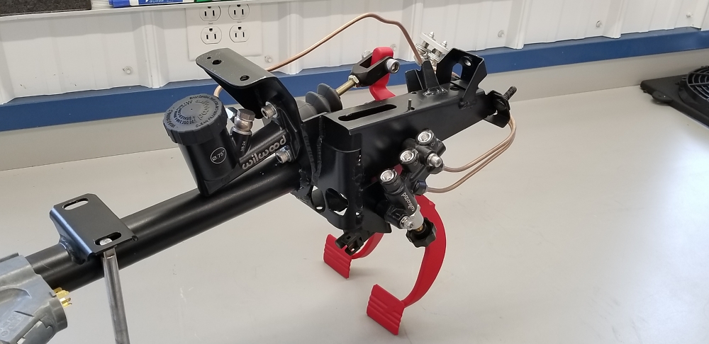

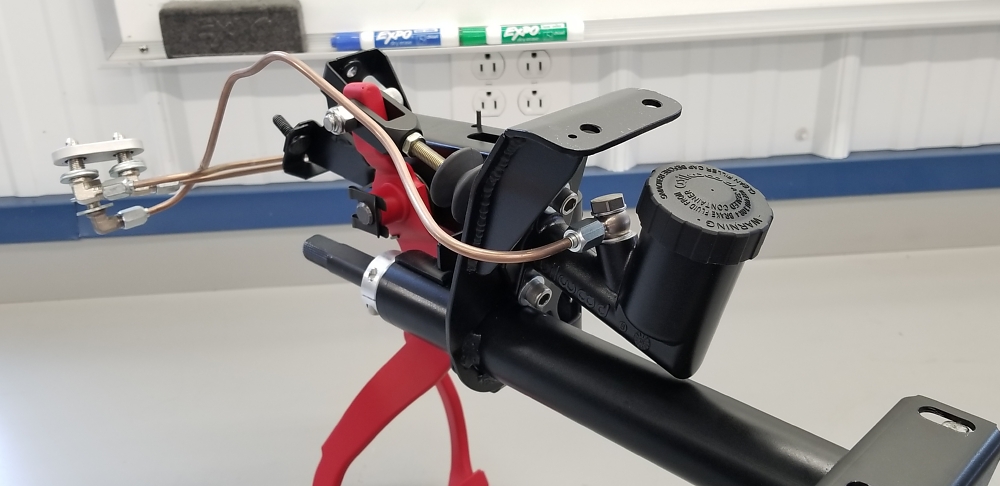

I got the pedal arms back from powder a couple months ago and reassembled the column. So thats all ready to go in.

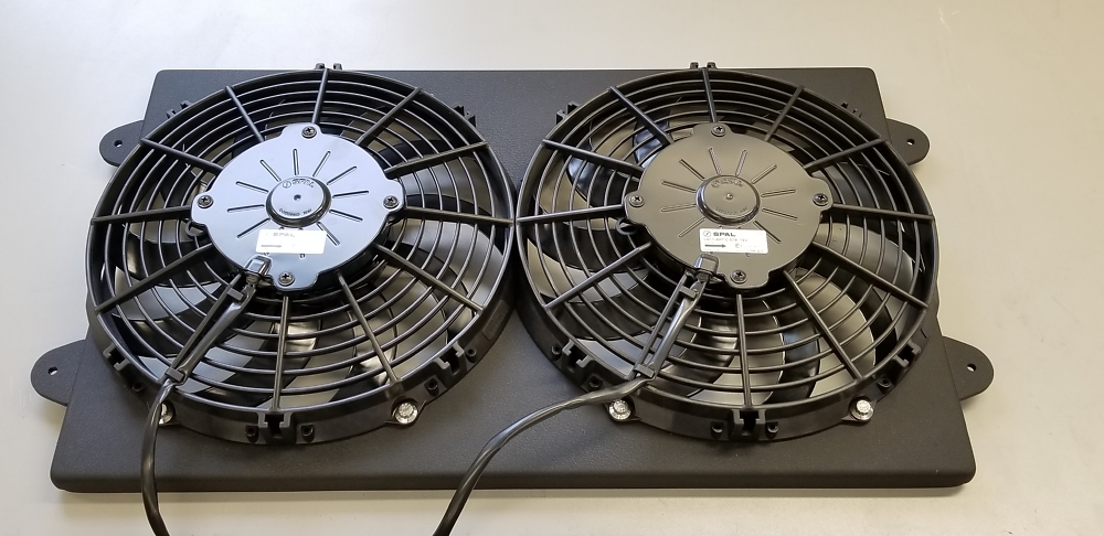

And mounted the fans to the shroud with some completely unnecessary 12pt SS ARP bolts.

Took me a second to recognize that the pedals are attached to the steering column?
Yup. The gas pedal attaches to the firewall. Thanks 1970’s vw design.
Well, originally it was sorta two pieces, the pedal box held the column. But with my new design they ended up being connected.
