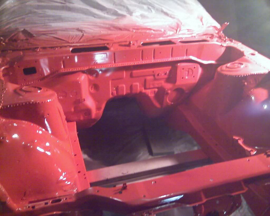

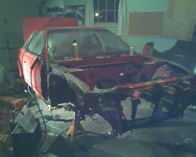

I painted the engine bay, interior and inside the trunk and im going to do the outside once I get the bodywork done.
its really not that hard just dont skip any of the prep steps and take your time while paying alot of attention to detail.
If you are going to do it in a garage like me, make sure you have ALOT of lighting, its like painting in the dark without it
