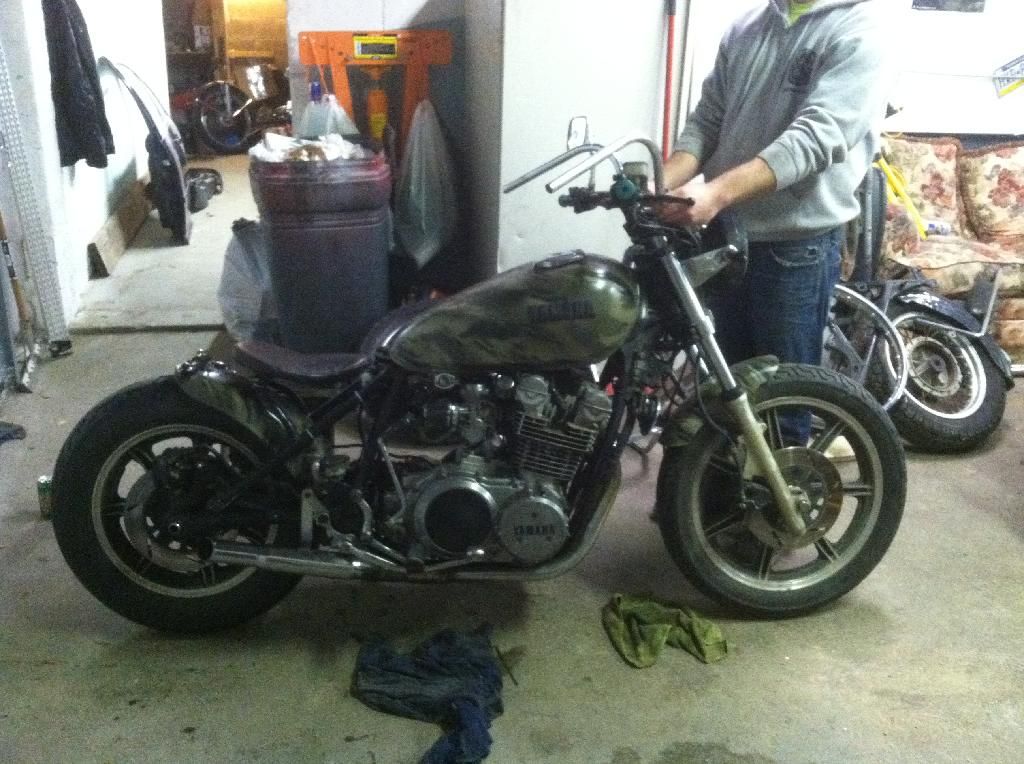

heres some pics of my brothers xs850 hardtail Ive been buttoning up a few things on. installed new battery/plugs/Beck grips.
we have a few sets of more “chopper-ish” bars kickin around, found a set I’m gonna slap on tomorrow and make it more comfy haha!

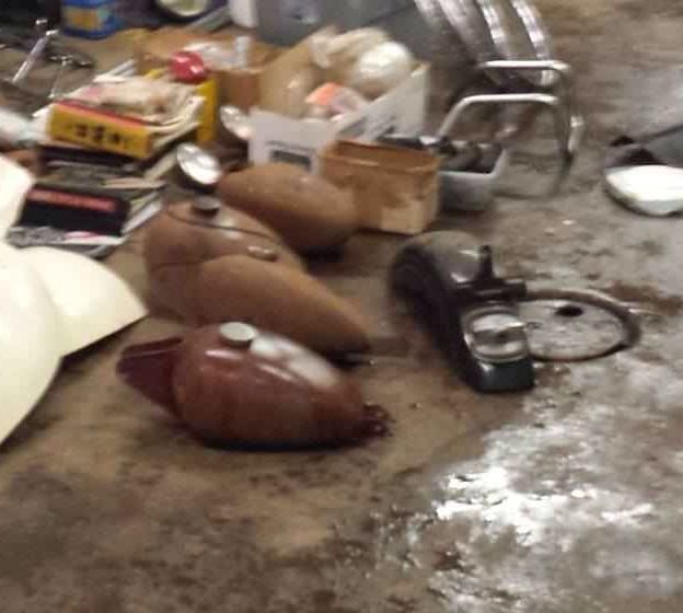

i think a new tank would make a world of difference
Agreed. We have a few old tiny chopper tanks I’m dying to use! But the frame isn’t a single backbone, it two parallel bars under the tank and are pretty wide.
yeah, these yamaha triples are hard to tank-swap because of the way the backbone is, especially since between the tubes is where all three coils mount, and the reserve lighting relay, and a few other large-ish electrical componants…only other way is to run a half-half tank off a harley and make a custom center strip/cover.
