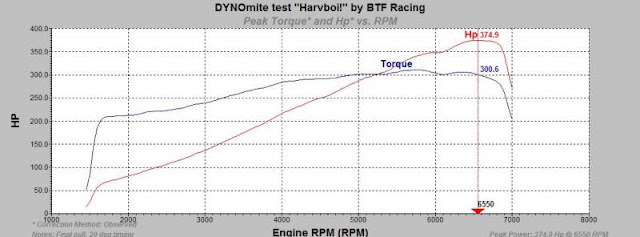

so i made it to bald turbo freak’s dyno and got the tune figured out pretty well. its a land and sea dynomite chassis dynamometer that is comparable to a mustang dyno. he said typically his numbers are 15% lower than a dynojet. except on the dyno i had a misfire at ~6200rpm. i changed plugs on the dyno and gapped em down to .030. they were at .034. still had the miss-fire for everypull except for one of em. the next day i checked the plugs only to find out two or em were at .036. so i never gapped those two plugs down; oops. but either way, the tune is solid and my AFRs are good.
id like to thank Rick for helping me out with the tune. i plan on heading back to the BTF mountain to get my forged internals when the time comes!
this is the cal i drove home on:

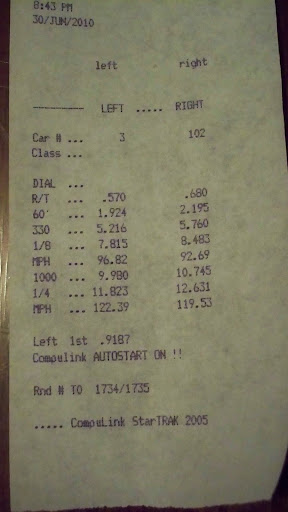

went to the track last night. pulled a best of 12.63@119.5. 2.19 60ft on stock sized tires. only mods are the blower, 3.73s, and X pipe. shes a bit of a pig now too, 3610 with me in it.
according to my weight and trap speed, im making about 480whp using those hp-guesstimators. here are a few vids and pics:

so i got the car down to 12.07@119.8 with a 1.98 60ft on 235 DRs. the next pass i cut a 1.92 60ft, definitely gunna be an 11 second pass, but i hit second and my clutch started slipping. its the stock clutch i think so it was on borrowed time.

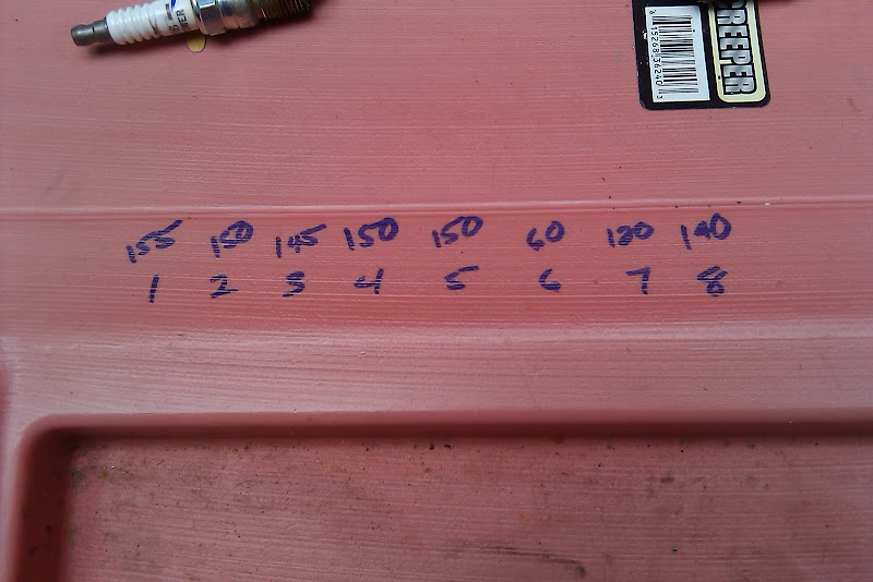

and speaking of borrowed time, a recent compression test (after bursting a valve cover gasket, hmm) revealed cylinders 6 and 7 to be low. cylinder 6 was almost 60% too low, haha.
and i got some serious smoke coming out of the PCV lines, so id say its time for some forged pistons. im almost 100% certain its some fubar’d ringlands, as theyre almost always the first thing to go. plan on doing just a regular rebuild with a some wisecos and either manley or K1 H-beams in the teksid block, a billet geared oil pump, and some head studs. stock B heads. maybe a short runner IM. KISS. i may spring for an Aluminator short block. depends on what is damaged when i pull the motor apart.
