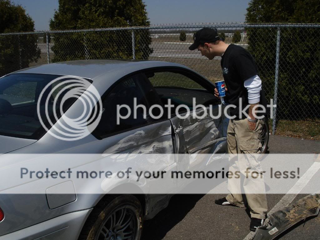

E46 M3 + wall = major fail
But yeah, aside from that this thread has more win than you can shake a stick at :ahh
::slight_smile: Whatever, that picture is so win. It proves my invincibility.
Bah, it wasn’t YOU that put it into the wall so it’s still a win your you’re realm of things
