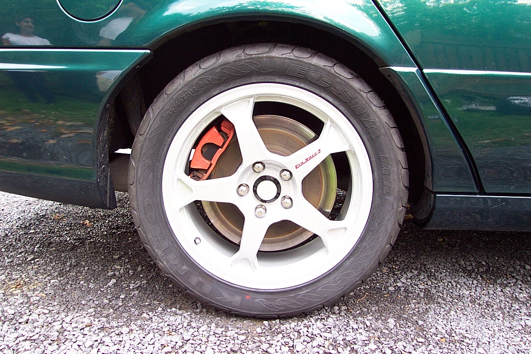

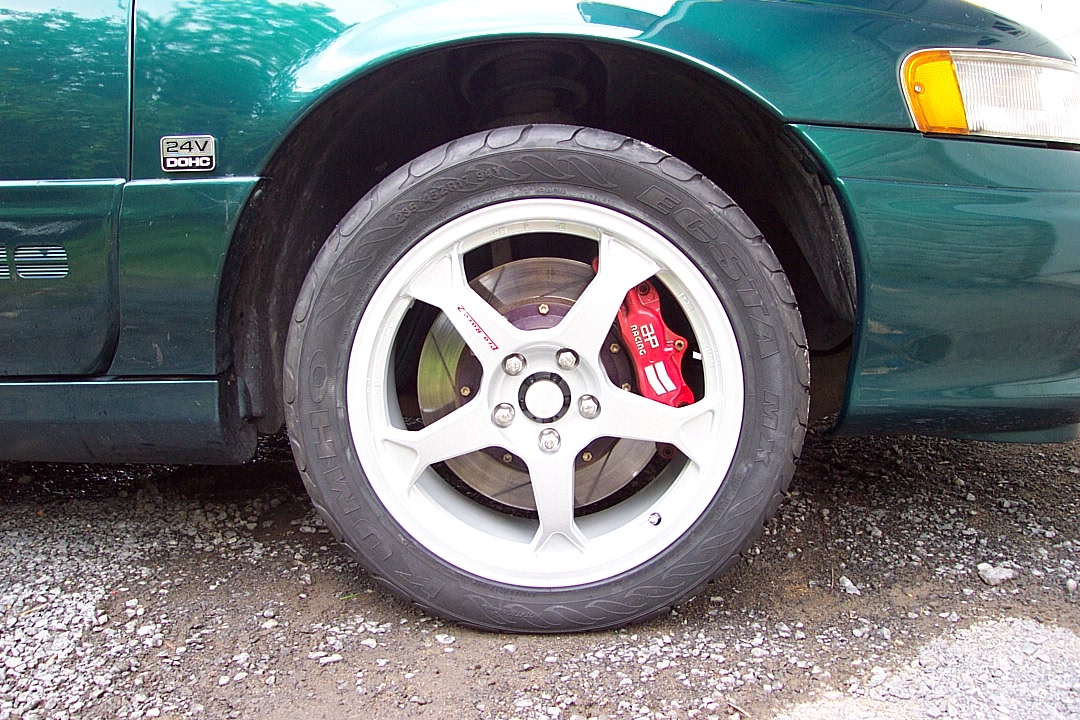

speaking of big brakes these may be the ones I end up with in the spring.
http://www.shonutperformance.com/PRII_17x7_Silver_front_green.jpg (front)
http://www.shonutperformance.com/PRII_17x7_Silver_rear_green.jpg (rear)
the pic show the 4 pot and i’m going to go with the 6 pot so the pads wear better (same clamping force) 13X1.1 front and 11.6 rear. new rims and some sticky tires. should be a blast on a road course.
if you want i’ll bring over my old calapers and see if they will bolt up to your focus. my stock 11.6 brakes would kick ass on your car.
