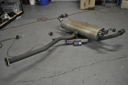

Ross Temple built my RX8 exhaust, and as many of you know that car is still alive and racing - and sounds brutal.  The weight savings were huge.
So I asked him to do it again for my 911.
Predictably awesome results.
This man is an actual Wizard.

Please feel free to put whatever kind of exhaust you’d like on your 911.
This saved approximately 40 lbs.  My GT3 seats chopped off another 50 lbs.  my wheels saved around 20 lbs and are 1" wider.
The car weighed 2904 lbs to begin with.
              Did you consider aluminum?
I had an aluminum exhaust on last year’s race car which failed halfway through the season.  It was 6 lbs.
I met Ross who built the cages on a few of the endurance cars I stared racing and he built me a steel replacement.  It was 12 lbs.

Then why have mufflers? What material is that? If it’s 16ga 304ss or mild steel then this statement is a lie.
Because the series I race in has strict decibel limits which I can’t exceed.
the EGTs from a rotary are typically higher than other cars.  Readings as high as 1800 degrees.
Couple that with intense runs followed by periods of inaction and you’ve got a lot of stress on the material which is why it failed.

Looking at pictures of your old AL exhaust, it was insufficiently supported.  I suspect the thermal effects could have been mitigated with proper support.
If you were that concerned about weight, you could have used a short radius 180 bend at the top and eliminated a lot of pipe.  Maybe you should have had a fabricator build your exhaust instead of Harry Potter.
