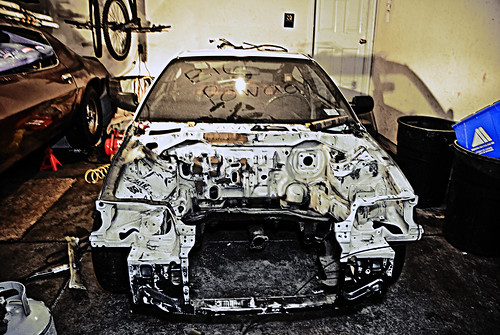

primer is finished, im waiting on my 90 degree female to female fitting because they are on backorder through summit.
I need this in order to find out where im going to mount the bulkhead to 90 degree fitting to fuel filter on the firewall
sometime in march the engine bay will be painted,then I can start to reassemble
