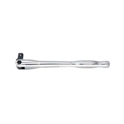

get a 1/4 non ratching, beaker bar style.
With a 11mm or 7/16 socket
