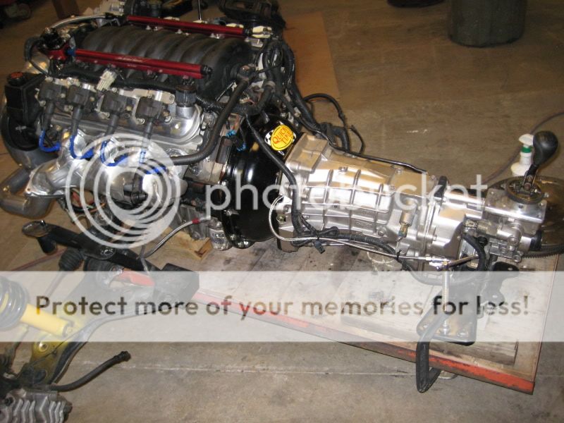

Fbod Clutch: SPEC 3 INSTALLED 4/9

SPEC Stage 3 - easy to drive and great holding power
This is what im going with, i also drove 2 cars with this clutch, its a harder pedal then stock but easy to drive. Just waiting on parts, will be in this weekend, cant wait to drive my car again!
