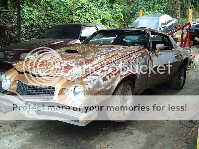

Hey, I’m building a shitty missile car atm. It’s rusted, it’s rotten so I don’t want to drop a ton of money on it. Basically I’m going to get mostly used parts and spend around $600 on a turbo setup. This is going to be bare minimums because the car was free.
So basically I’m going to pull an old t-3 out of a saab, get some rando manifold from ebay, and then go ham with oil lines and an ebay intercooler and piping. I know it’s not ideal and won’t be reliable.
I’ve heard the ecu in the ka’s is good til about 210-220hp. Is that true? I’m not against buying another ecu but 210 is fine with me if I don’t need to spend the money. Keep in mind I’m not getting this road legal, or track ready. It’s just for driving around the farm.
