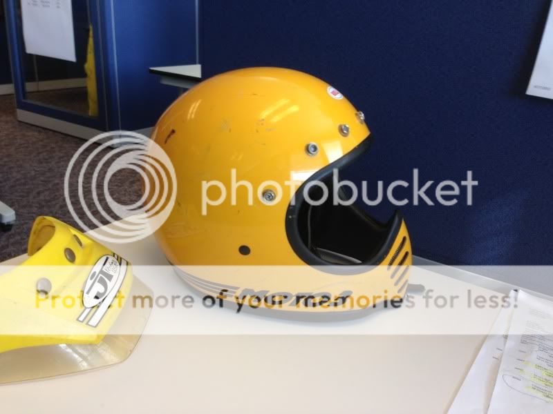

Oh hey… so when I was looking around for a vintage moto helmet, I had reached out to a guy at work who rides dirtbikes and used to race. He said he may have a lead on an old Bell Moto 3 from his buddy. I didn’t put much thought into it after picking up that old Fulmer, but he just texted me today saying he came through. I’m coppin’ your style a bit Newman, but I couldn’t pass this up. It was next to nothing. He just dropped it off at my desk 5 min ago.
I guess i’m collecting crappy old helmets now… and no… don’t ask me to sell one just yet guys.
-Paul
I hate you. I’ve been hunting for an old Maxon helmet for WEEKS, or a Bell Moto4.
I don’t even want to tell you what I scooped this for. :snky:
if you told me, I’d have to kill you.
Old helmets…meh.
I like my RF-1000. I know for a fact mine can get run over by a bus and remain intact, those helmet…not so much.
Same color as well, that’s cute. What did you pick it up for if you don’t mind me asking? Want to sell your Fulmer?
lol, yeah yeah. I really want a white moto3 but I couldn’t pass this up. I don’t want to sell either at this point. I like the fulmer a lot and it’s in a bit better shape than this, but this bell fits a little less snug. I’ll figure out what I want to keep and let you know.
Moto, I hear you, but at the same time it’s safer than the damn skull caps or open face fggtry you see everywhere. I have a modern hjc as well. Maybe i’ll just firesale all 3 and buy an 1100.:stuck_out_tongue:
