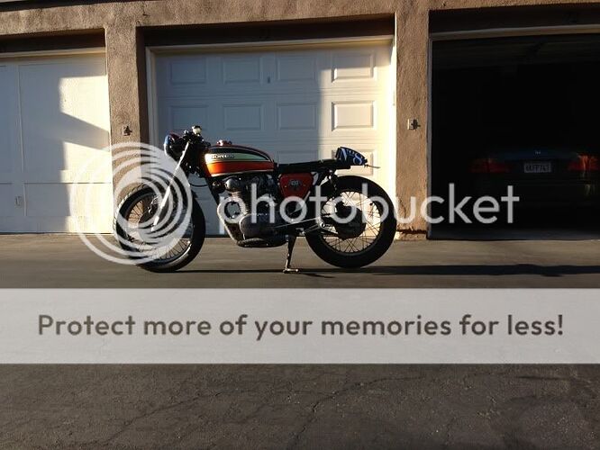

New home.
new front end, clipons, hl ears, mc. It totally changes the front end, and I love it.
