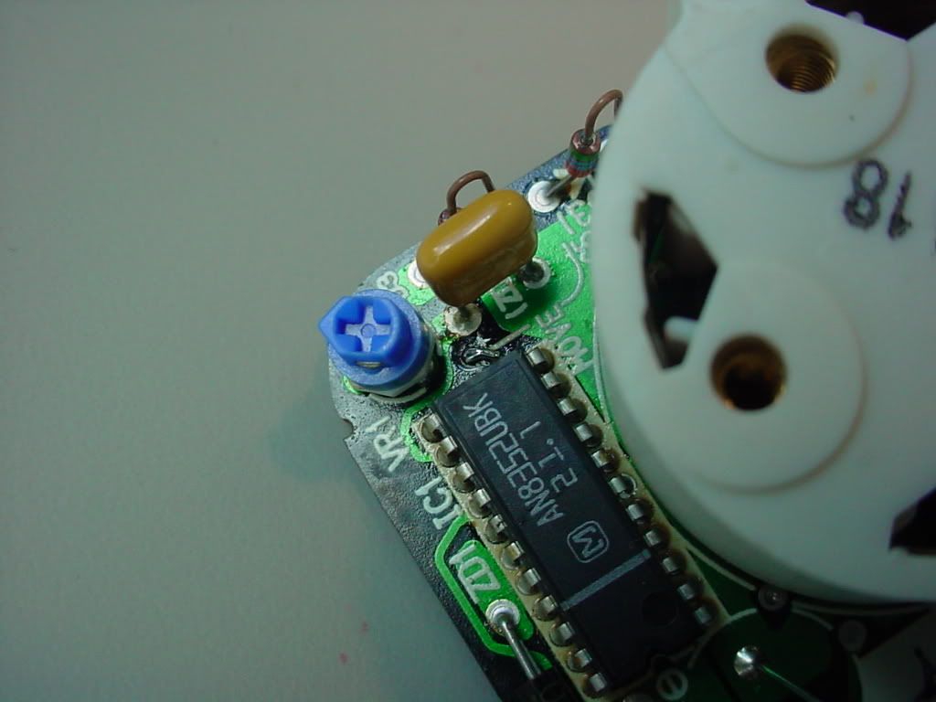

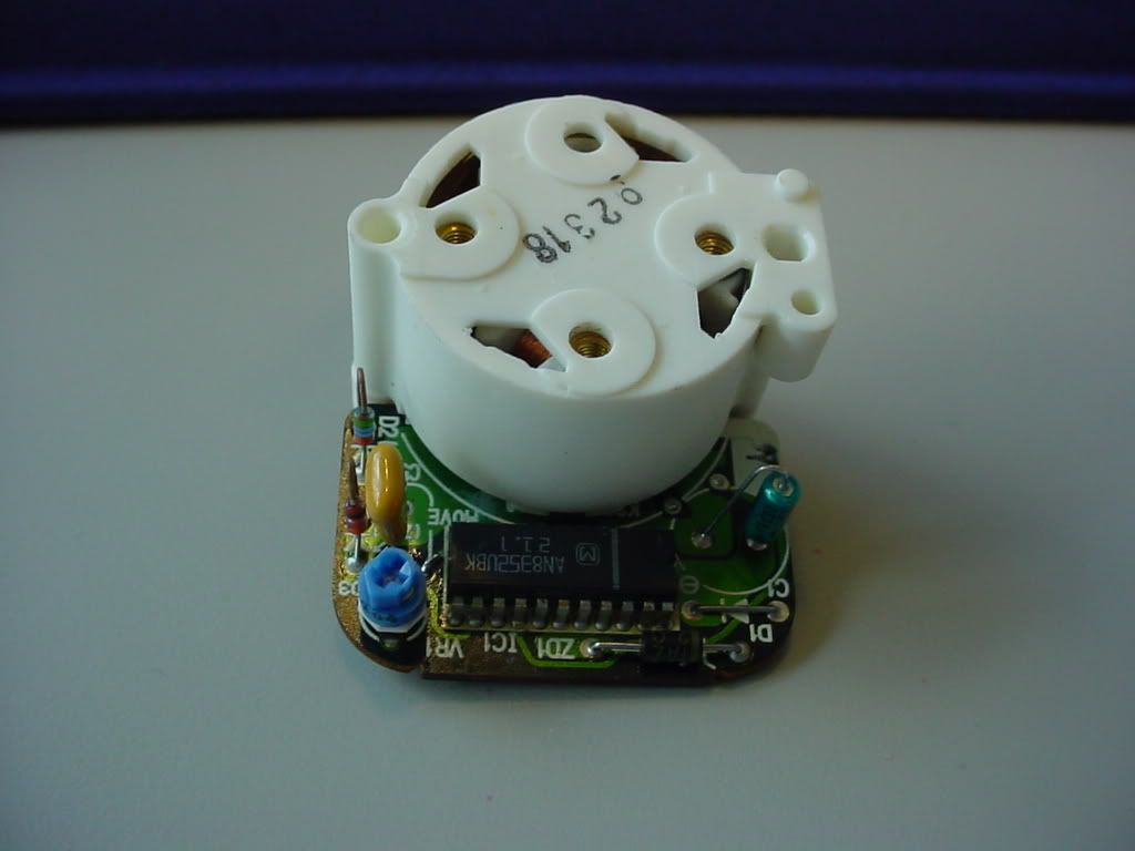

I pulled the tach apart. The gasket around the “Cruise” light was shot. Not that it mattered but I replaced that.
C1 and C5 were shot. I replaced them.
The pad connecting Pin 3 on VR1 was lifted. I did not notice this originally when I removed the bad caps. I may have contributed to the problem but it was definitely gone. I scraped the solder resist back and solder bus wire to it. It’s not going anywhere now. I called Pat and I will bring it back to him tonight. I’ll stick around while he installs it to make sure everything is working.

Tach works now…woo!

looks like the solder joints on ALL the diodes are bad also. Very nice car/setup!
Nope, they are just oxidized. As far as fillet size, wet-a-bility, and cleanliness they fail IPC-610 Class 3 standards…but they are fine for a RX7 Tach. Good eye to catch them though…:tup:
