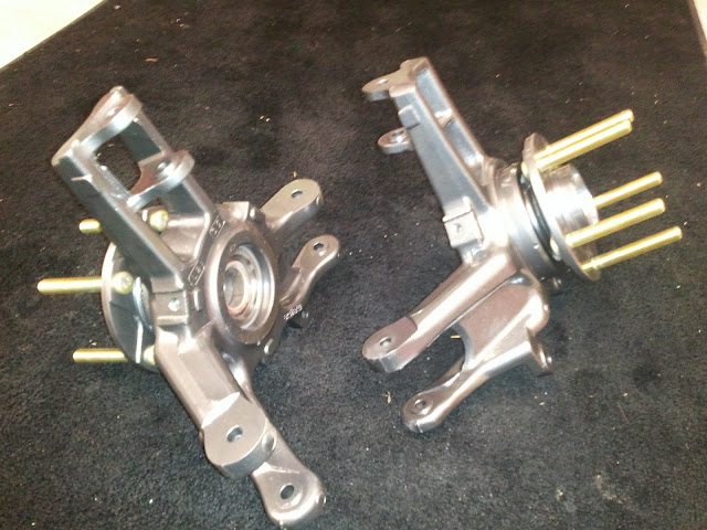

I already pressed out all of the delrin bushing set that I run. The remaining few are four pillow ball that I have replacement for and two big ones that are a solid rubber type bushing that I will keep in. All wheel bearings were replaced. Then new grease and rubber boots are installed as well. Calipers get rebuilt etc etc etc. That reminds me I did the hubs and did new wheel bearings and ARP extended studs as well as powdered the ds and forgot to post pics! wtf! lol
