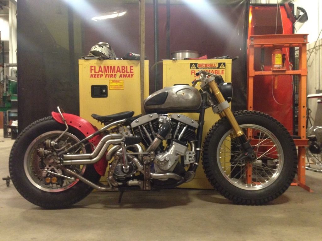

My sponsored 78 shovelhead build thread
AHHH the turbo is so cute and little, I wanna wear it around my neck!
Your man card…leave it on the table…you don’t deserve it anymore after this comment…
[sarcasm]AHHH the turbo is so cute and little, I wanna wear it around my neck! [/sarcasm]
:tup: Awesome.
That linkage looks perfect.
I lost that thing a long time ago
Newman! You’re a mastermind. As always, keep up the great work!

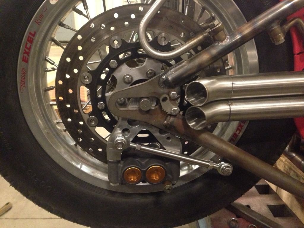

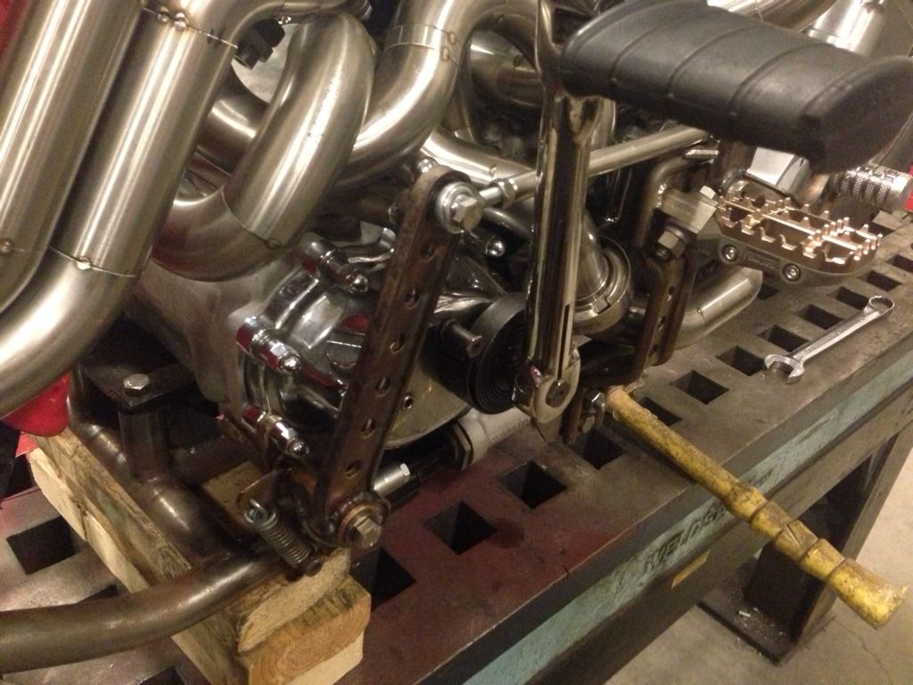

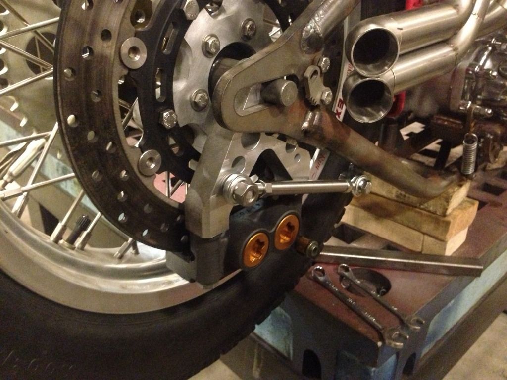

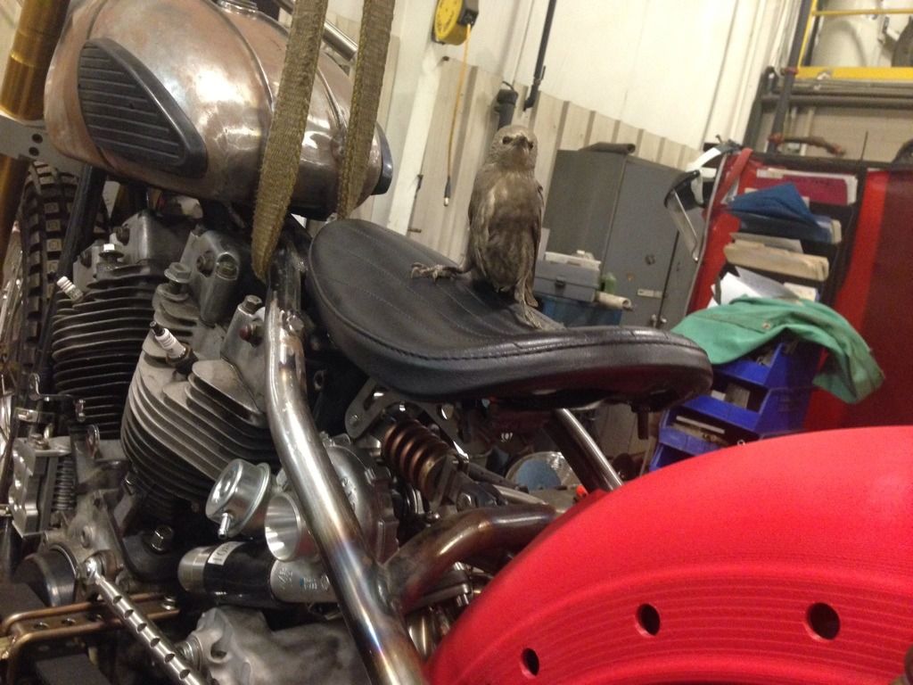

But then I got back into the shop yesterday. Made this caliper bracket, and added a return spring to the brake linkage. Everything came out well. Then I made a friend:
I knew this shit was for the birds.

Wingsuit and bird in the same post? Hmmm.

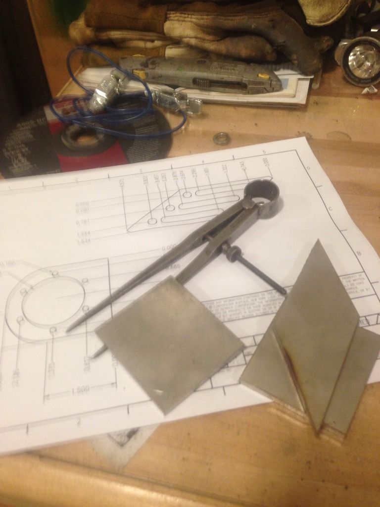

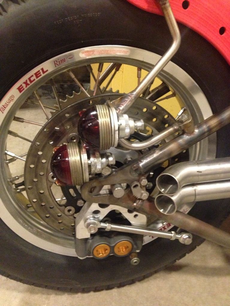

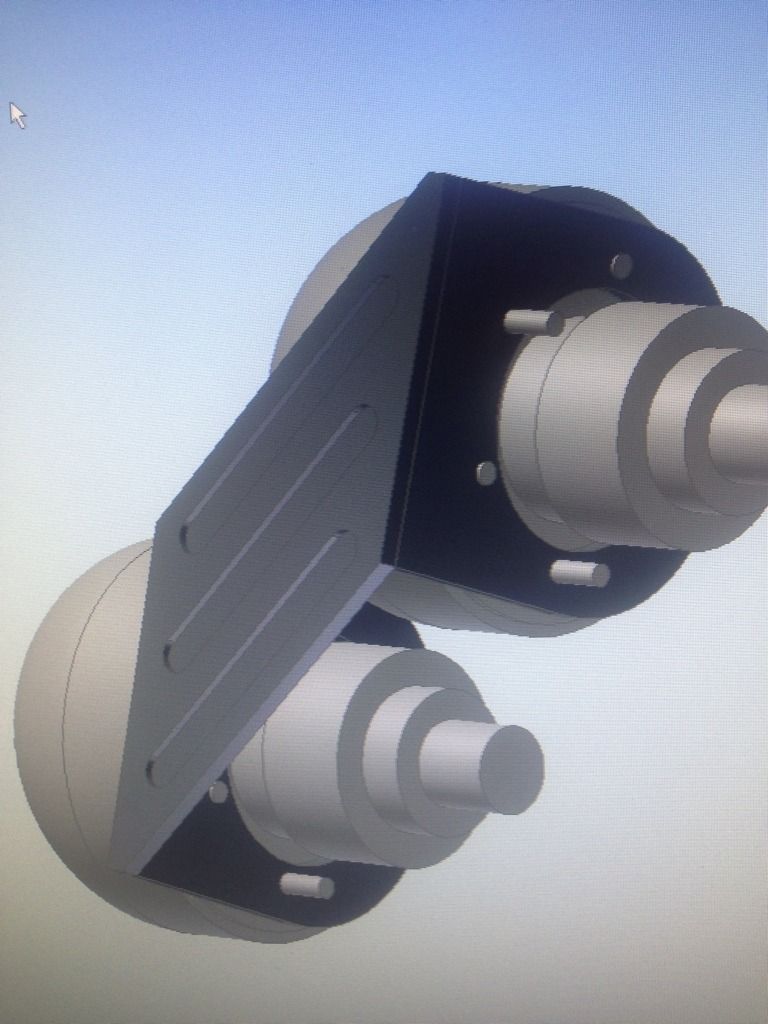

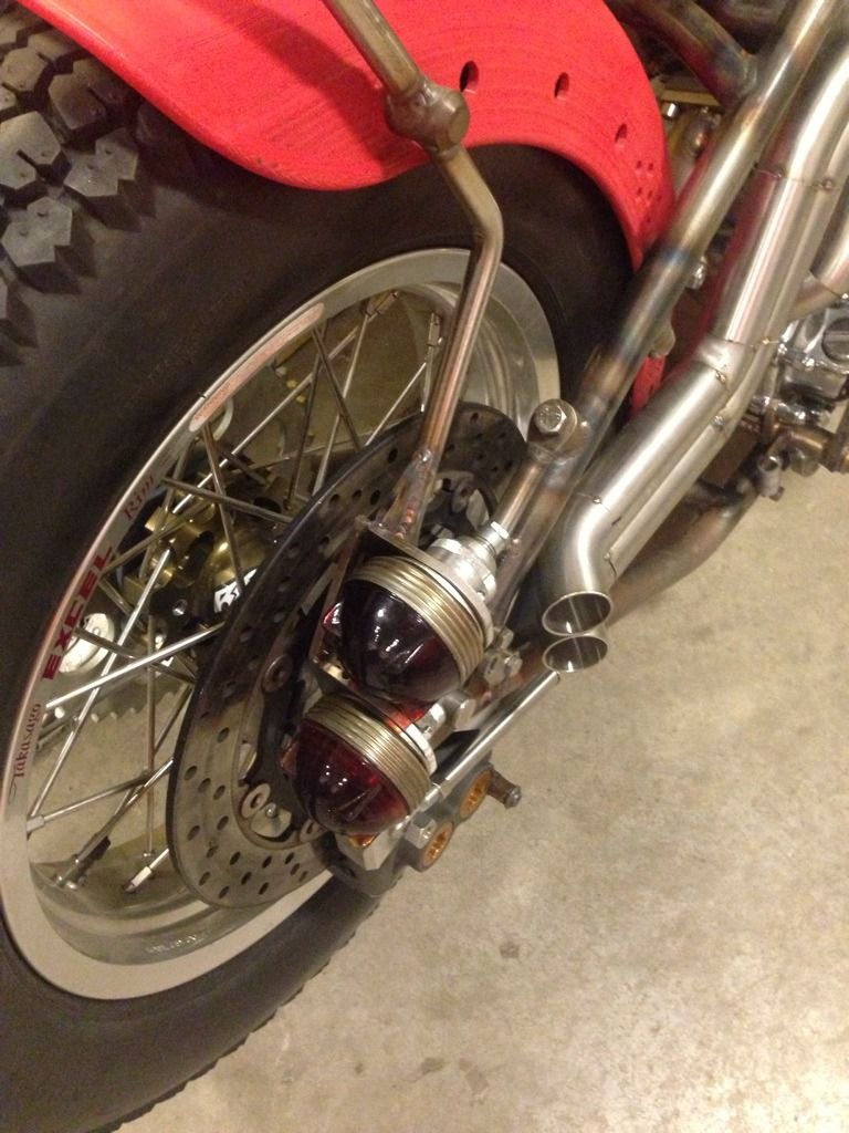

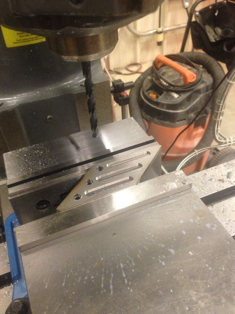

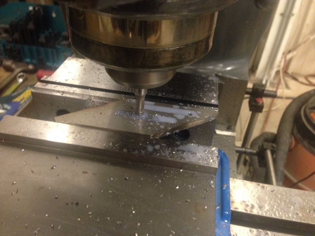

So I made a bracket to mount those British tank taillights tonight. A little cad action:
Then more stuff:

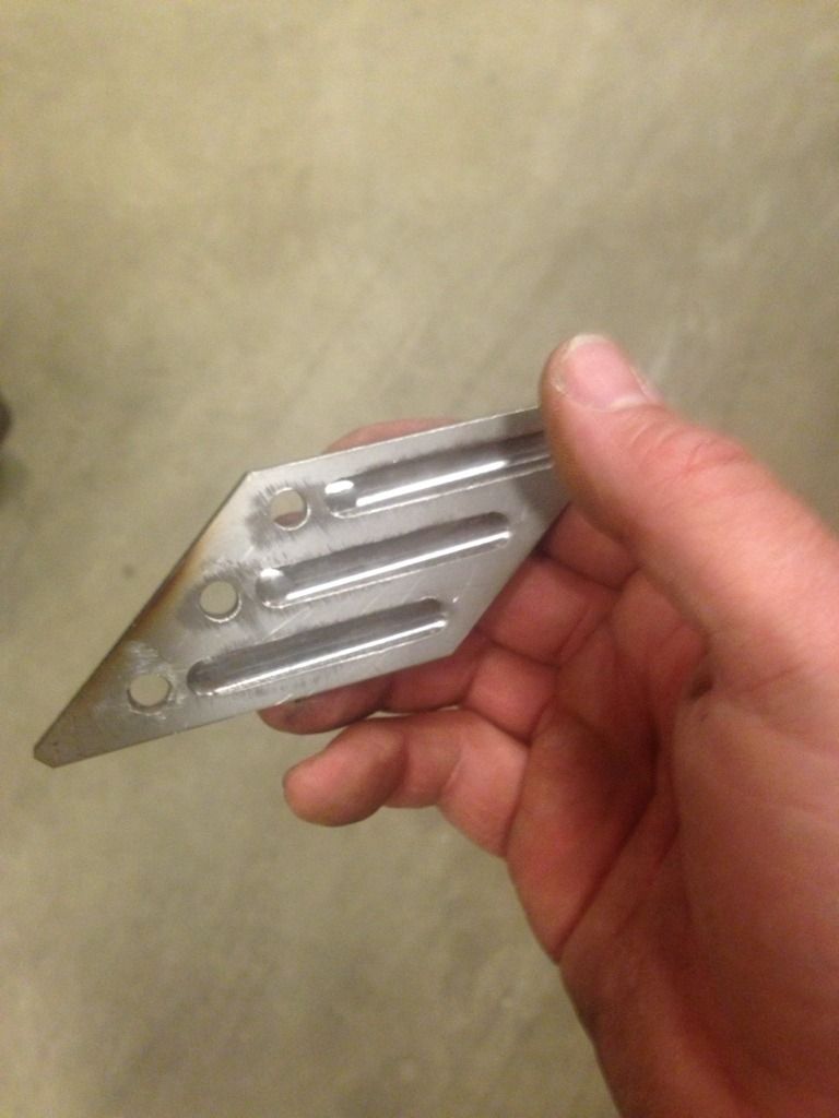

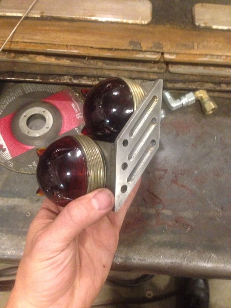

And then I welded it all together. It was at this point that I realized it looked way to bulky…
So I cut it back apart and basically mirrored it so that the support (and the cool fancy slots) were hidden. Firmly welded to the sissy and a tab on the axle plate:
:tup:
This pic is fucking awesome. The bike is coming along ok as well. :wink:

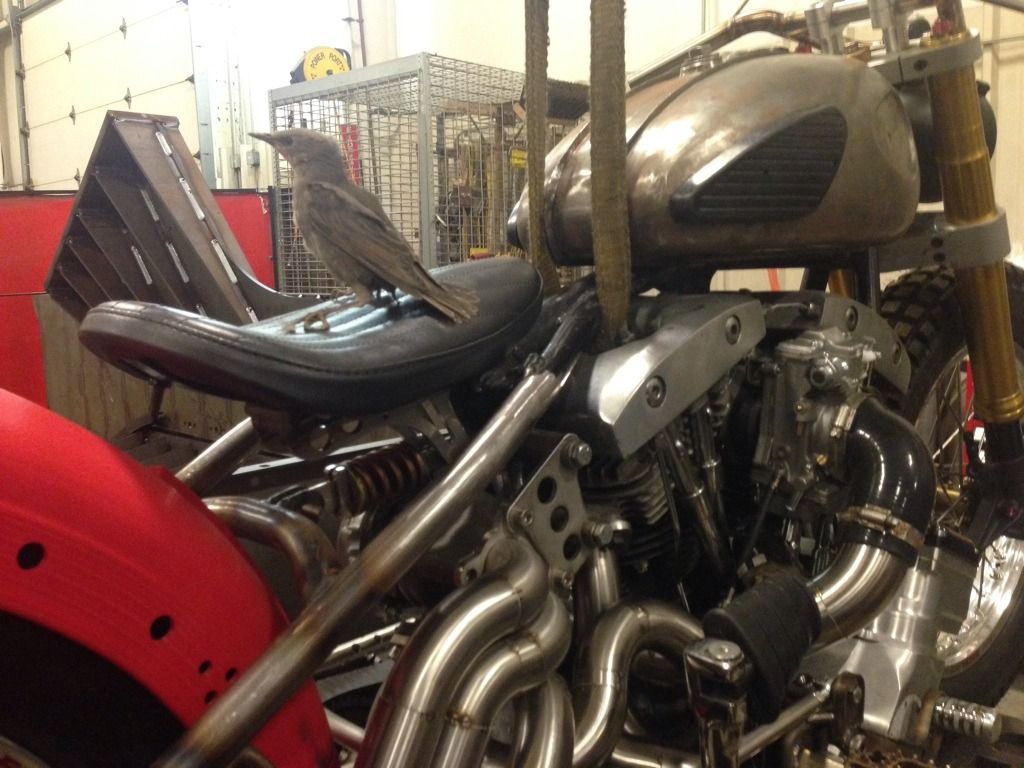

How much adjustment is there in the shifter lever and brake lever? I think you’ll have to raise them both for them to be comfortable while riding. Look at the shifter. There’s no way you’ll be able to get your foot under the lever with your arch on the footpeg. Your knees are going to be bent so much with the pegs so high. Maybe the pics are deceiving me?
They’re both lined up to where it’s comfortable for me on the bike. And there is no shifter on the bike yet. There is, however, a clutch pedal. :slight_smile:

As evidence to how cool this build is and you are, you just had to put a bird on it.
