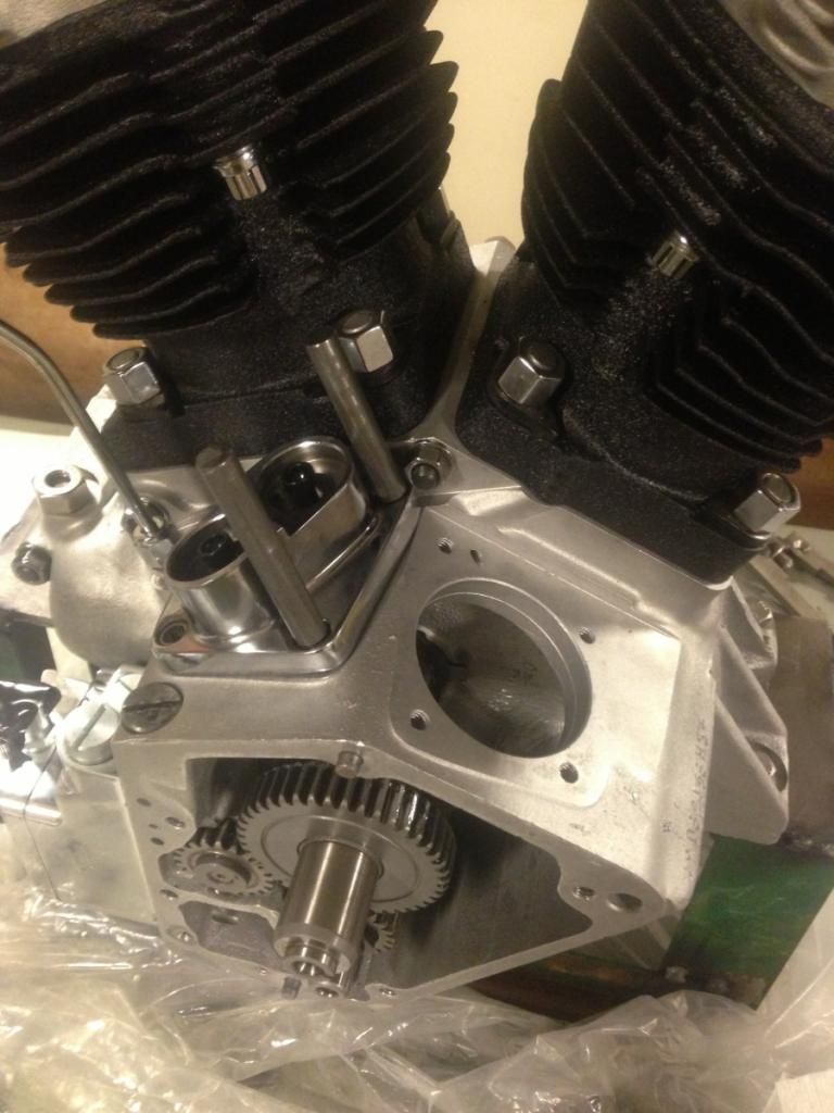

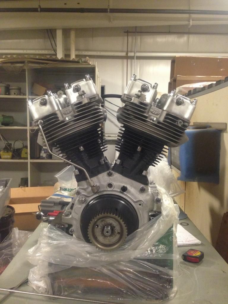

2 back to back 10 hour days (after working 8-5) and I have some progress.

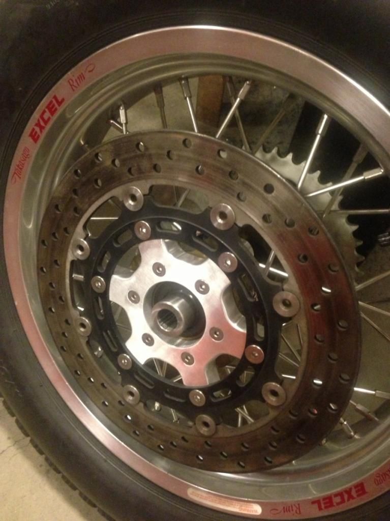

The first thing that I did was clean up the rotor adapter that I made (from a blank that WWWJ cut for me) and install it permanently with loctite and the appropriate stainless hardware. Kind of a before/after:
And then got to work on assembling more of the motor. Had to make some tappet alignment tools:

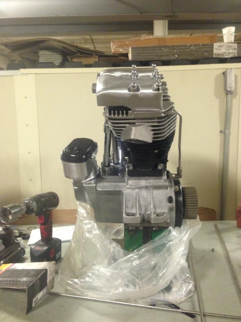

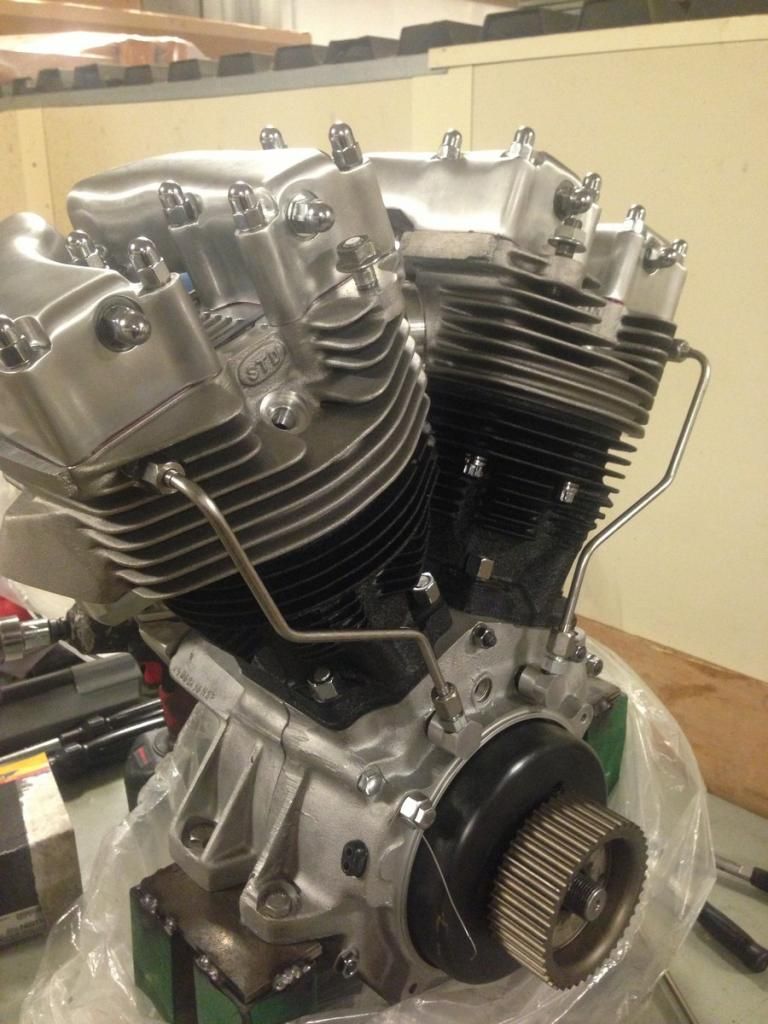

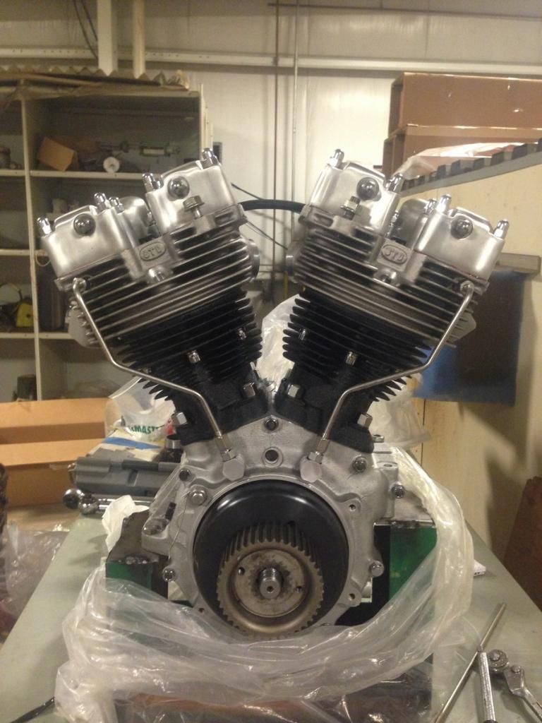

And then some shots of the motor with a lot of stuff installed. Still need to set the base timing with the magneto and install the oil seal and alternator bits on the drive side. Also need to plumb the head oil return lines.
For reference, before:

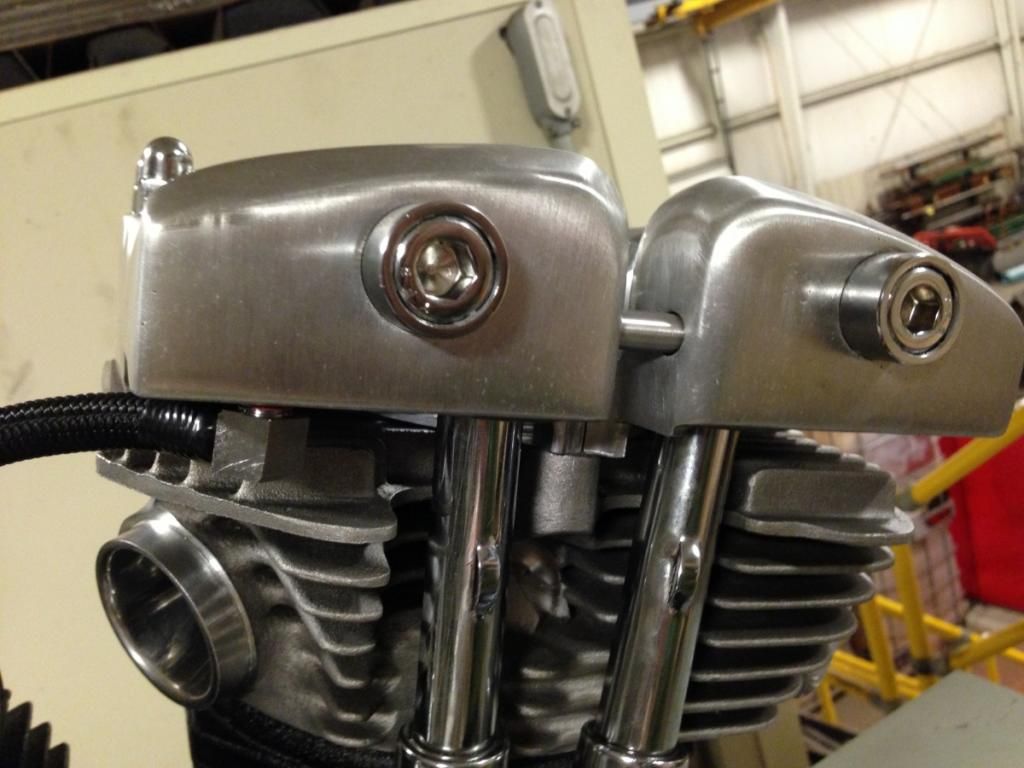

Here’s a closer shot of the split rockers:

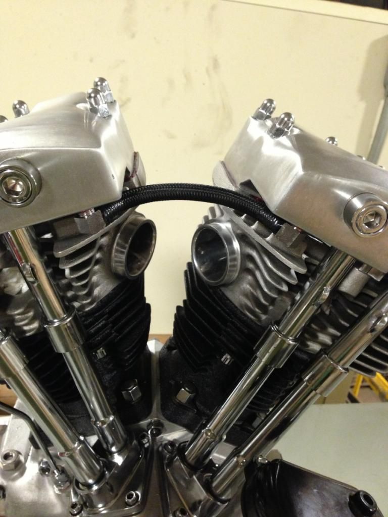

And a shot of how I rerouted the center oil line. It’s sort of hard to tell from the picture but the majority of the bend in the hose is towards the other side of the motor. It will be mostly behind the carb, which gives me more room for my throttle cable:

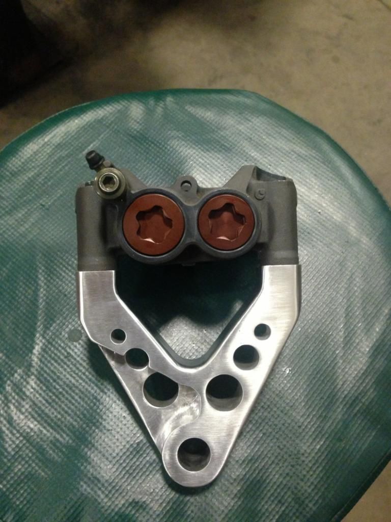

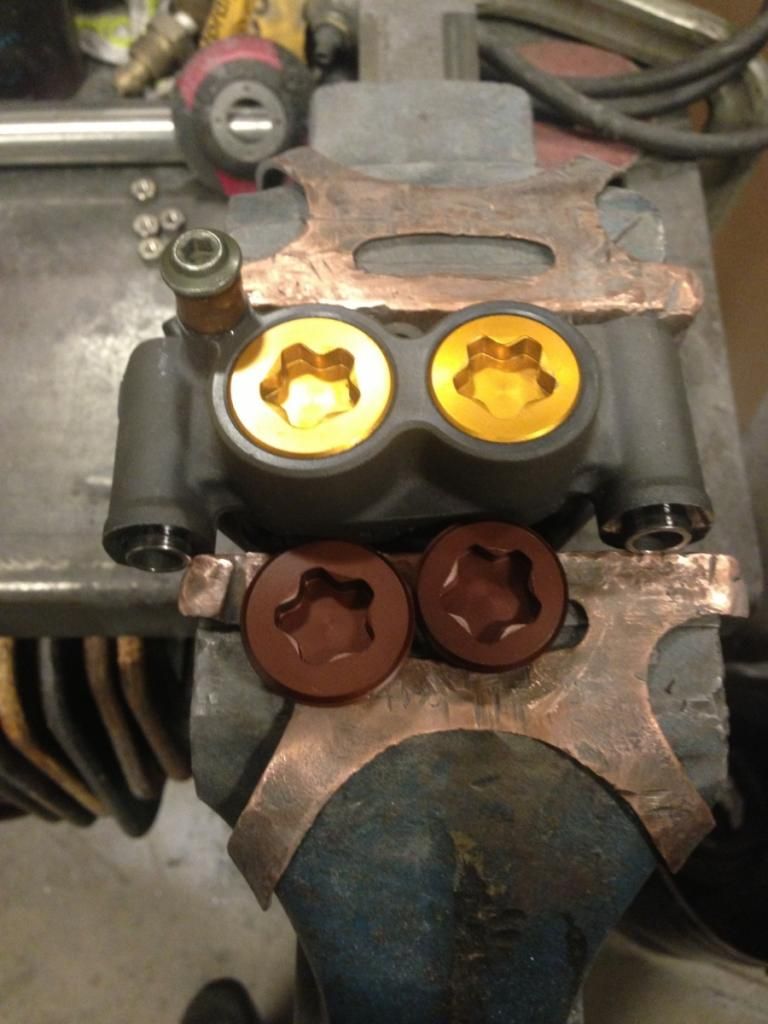

Also cleaned up the caliper bracket and installed new brown anodized “spots”. I have about 40 hours in metal polishing alone on this bike:

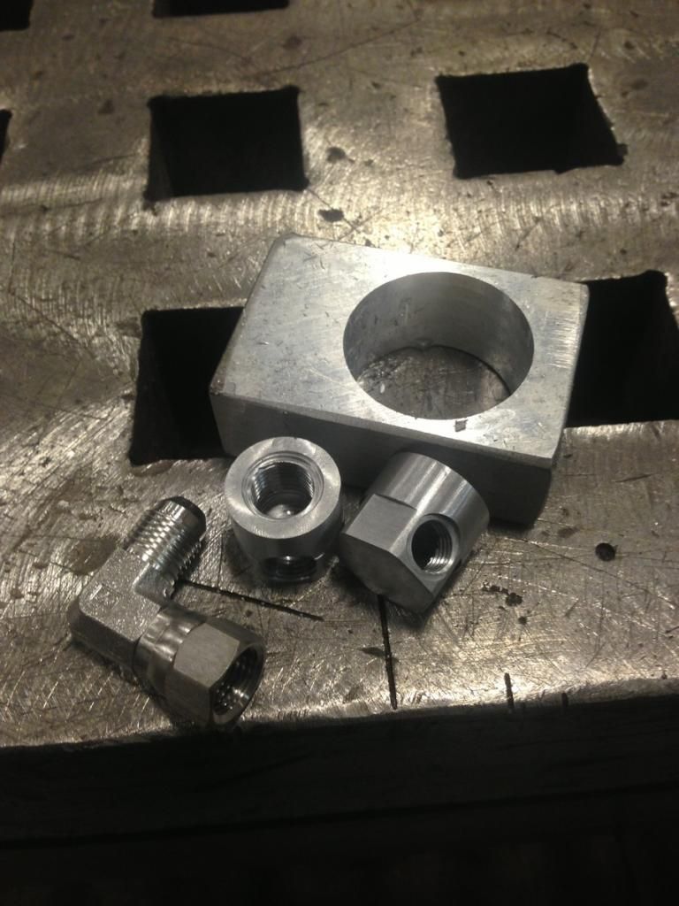

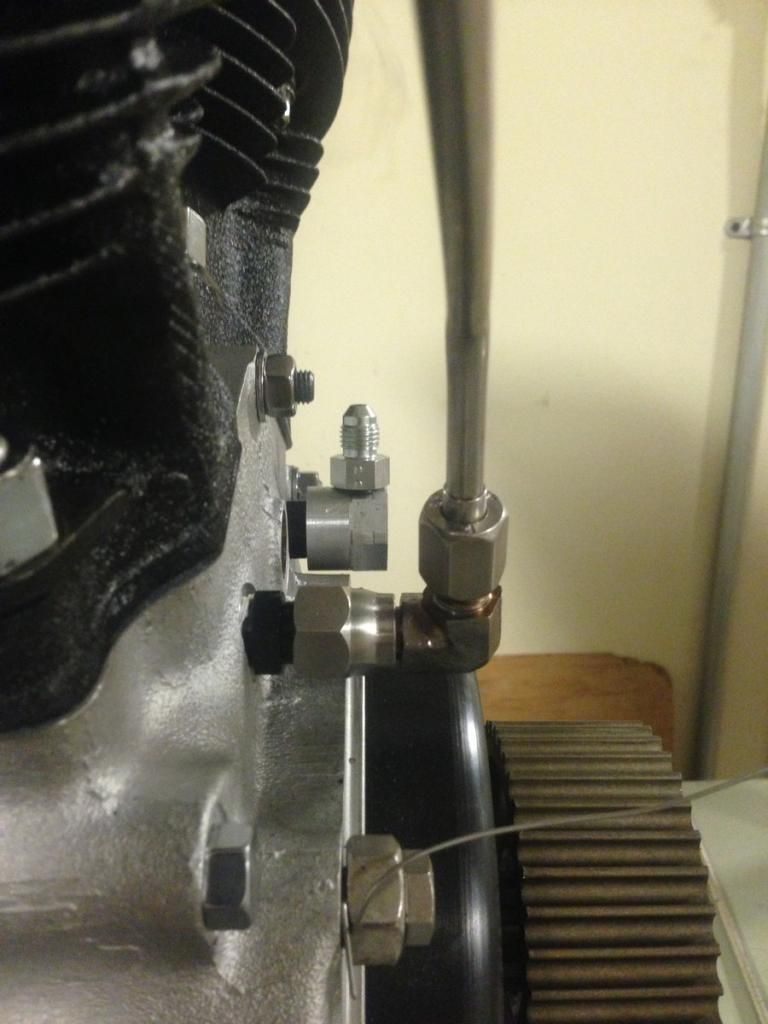

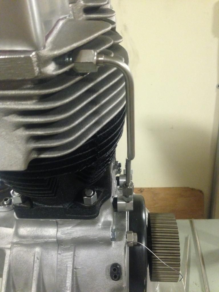

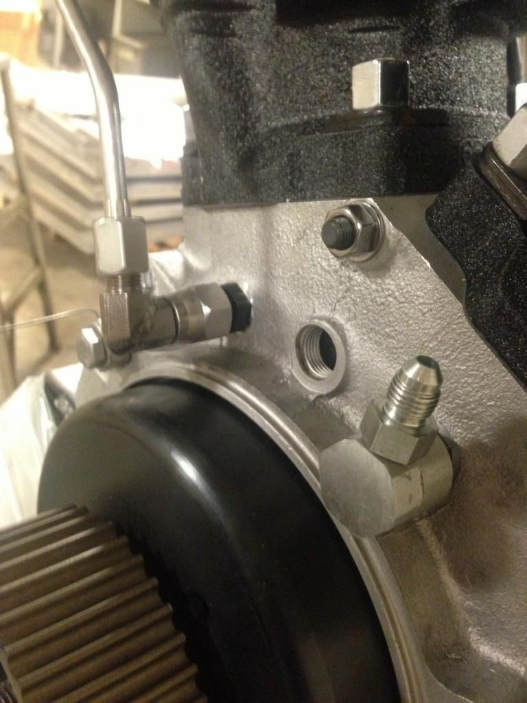

So I was installing external oil drains last night. I actually had to make a -4 male x -06 swivel elbow, but even with that installed, I didn’t like the way it looked. It stuck out too far and just looked “industrial” in a bad way.
Here’s how it looked:
Part of the problem was that I installed -06 fittings into the case. I couldn’t change these after the case was assembled either because they’re ground flush to the inside of the case. But a solution was to be had. I made these fittings (out of a wasteful solid chunk).
And here they are installed with the old fittings for comparison:
And with new lines made:

No shouldered lock washers behind the bolts for the rotor to the hub?
