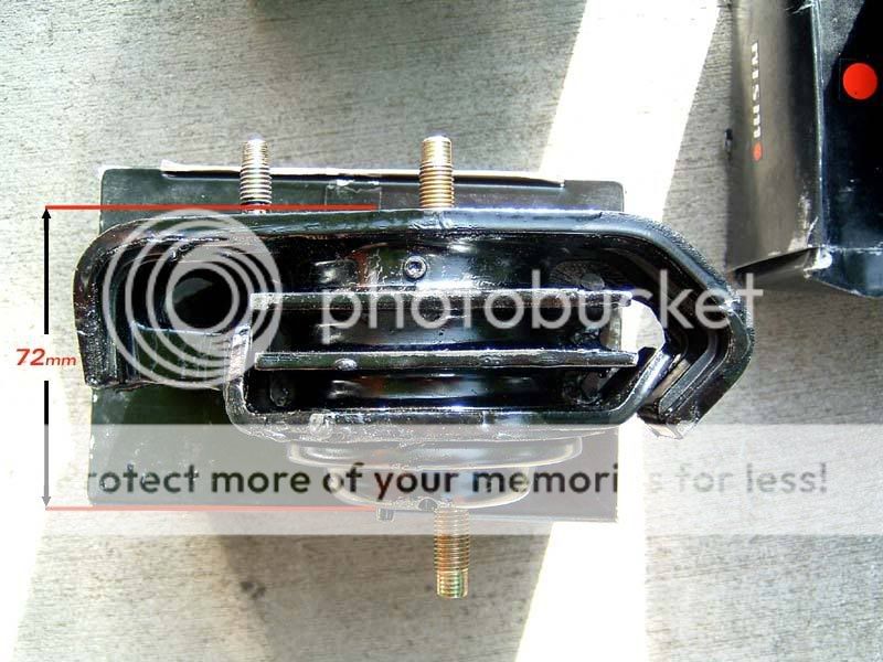

Apparently on nico some guys said that the nismo mounts sit the motor higher slightly.
New stock Nissan mounts = 69mm
New NISMO Nissan mounts = 72mm (both left and right sides)
http://img.photobucket.com/albums/v295/let5l1de/nico/lo_DSCF0116.jpg

and they actually sit 3 mm shorter then the stock mounts

How about slightly stiffer than nismo and cheaper in price while still good quality and lower, because the nismo sits like 10mm taller.

Who cares if it sits 10mm taller. (I dont even know if it actually does) It won’t make any difference at all.

I’ve noticed that my shifter sits about 10mm higher than before. I’m guessing the engine mounts make the motor sit higher as well… I’m gonna have to check.

my $0.02 on the whole “nismo mounts sit higher” deal…
think of it this way… your stock factory mounts are what ? 15yrs old in some cases and have 200k+ on them. SO, they actually begin to compresson and then sag over time. then when people install their nismo mounts they say “wtf, motor sits higher” well actually, its back at the proper/factory height since you no longer have worn out mounts.
quite a few people on this board alone have gone and removed their engine to find the oem mount is “broken” since they were so worn from time.
Thanks GT,
