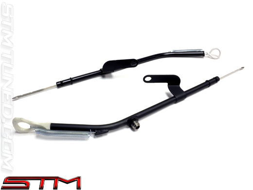

Oh No!! Fire! STM's solution to your DSM dipstick popping out.
http://www.streettunedmotorsports.com/parts/b/stm_dsm_sprung_dipstick.jpg
Click the image for more information.
Sick of your DSM oil dipstick popping out, spraying oil everywhere and potentially creating a severe fire hazard? :confused:
Don’t worry, STM is here to help.
We start with a brand new, OEM oil dipstick tube and weld on a small hook for a spring to securely hold the dipstick in place and keep it from popping out.
Then finish it all with a satin black coat of paint.
No more oil all over the place, no more fire hazard, no more worries.
  • New OEM Oil Dipstick
  • New OEM Dipstick Tube
  • Spring
  • Satin Black Finish
  • Fits 90-99 DSM (Select 6 or 7 bolt motor)
$49.00
