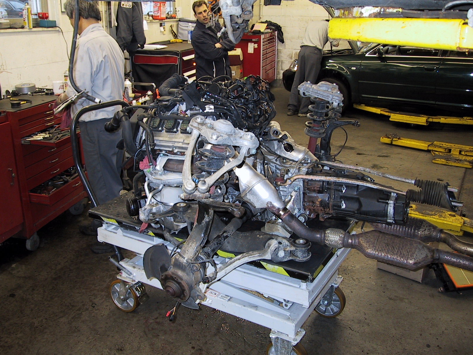

I’ve got quite a few friends with the B5 S4, and it amazes me how anyone would want to work on that.
Pulling a manifold or turbo off my car can be done in 30 minutes. On the B5 S4, not fun.
Here is a pic of one friend’s, for nothing but turbo replacement:

dude…nothing is further from the truth. You’re going to be surprised! I have maintenance records from the s4 i just bought, it was 700 in parts and 650 in labor. 9 hours to pull the motor and replace the belt and tensioners / waterpump. You can get away with the parts around $300 - $400

thanks for the pic the audi is similar to kl series mazda v6,which I belive Dave has done a few of. either way not fun.http://www.pittspeed.com/uploaded/klze.jpg
nice… those are damn close. i hear the job sucks… the AWD system makes it that much more enjoyable.
Like i said, unless you’re doing it yourself, it’s a burden in the wallet.
