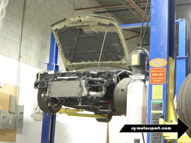

Speaking of updates!!!
http://i130.photobucket.com/albums/p245/Acidz1/AUG0807/DSC001395.jpg
http://i130.photobucket.com/albums/p245/Acidz1/AUG0807/DSC001396.jpg

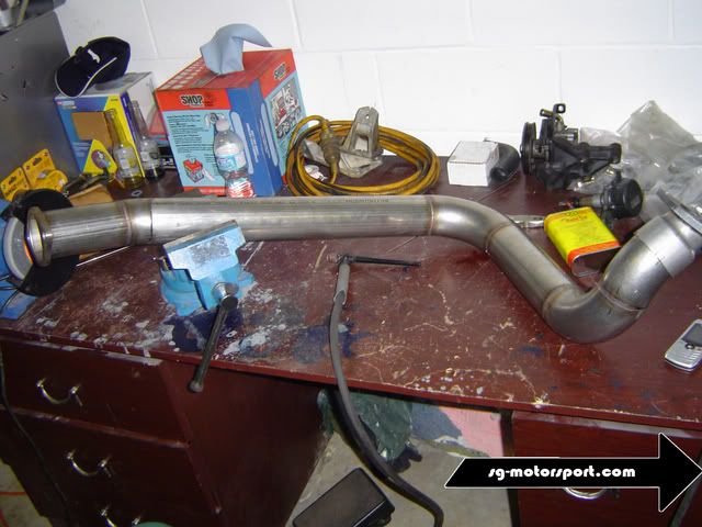

BAAHHHA cut that pipe open for the 02 BUNG
http://i130.photobucket.com/albums/p245/Acidz1/AUG0807/DSC001393.jpg
Most of it done [there is updated pics just sasha has them :frowning: ]
http://i130.photobucket.com/albums/p245/Acidz1/AUG0807/DSC001391.jpg

Umm had a coolant leak, but thats now fixed YES!!! now onto small simple things & tuning!!!
i also forgot after all that TO THE TRACK!!!
well i put in a stock ECU & i hope to do a quick pass on my street up and down and see if this sexy toy moves! i will try and get a vid for sure.
