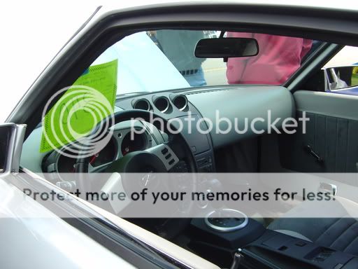

On another note- I have to say a 350z interior looks awesome in a 240z… you might consider if you can find a write-off 350z or 370z

For some reason I’m not a fan of the 350Z dash but if I ever see a 370Z dash that I can afford ( I found one but he asked for $1400 LOL) I will definitely be doing that.
