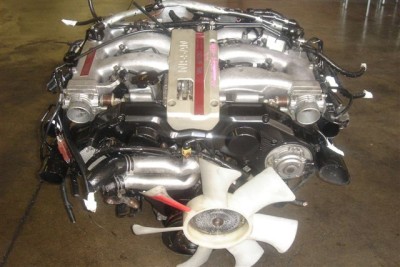

I came across the vg30dett out of a 300zx. I did even more searching and all the info i could find on it. I love the fact that, to start, its a v6, twin turbo engine with alot of torque. Though parts are pricey i can find the relativly easy, and on the other hand motor sets go for almost nothing compared to the RB’s.

i have been talking to a few that have done the vg30e swap, which is sohc engine, and no turbos, unlike the vg30dett. i got plelty of information and i bought the motor.
http://img.auctiva.com/imgdata/6/1/8/7/5/1/webimg/307739795_tp.jpg
As of now i tore it down so i can begin to replace gaskets, timing belts, etc. So far this motor is very cool. Different then a lot of motors ive had apart.

But for now main focus is the motor. Got to change to a front oil sump, One of the turbos might be bad idk yet, got to pull it apart more. has some oil leak from the valve cover, and getting it mounted up in the car.
Like cavi mike was mentioning, I would test fit the motor before you go tearing it down and rebuilding it incase it doesnt fit.
great motors. big though, hope it fits :tup:

The motor fits, I’ve seen a few of these swaps. But I can’t seem to find any info / pics from a quick search.

Man, I just do NOT understand swapping that engine in. Especially with how cheap VQ, VK, and VH’s are. (Not to mention easy to work on).
Are you kidding ? That may be so for an S12, But the bay on an S13 is huge. Literally the only modification needed for a VH is a 1" deep notch to the frame for the alternator, and thats only so you can use a stock bracket, which isn’t even necessary.
