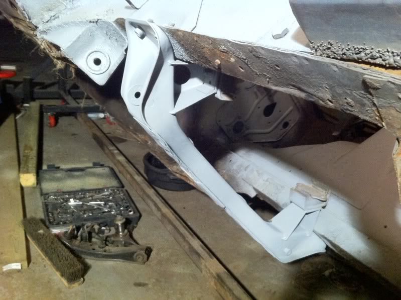

Had a few hours to work on the Z (I need a good name for her)…
Started with one of these…
Drilled a crapload of holes…
Cleaned the bish.
Primed a bit
