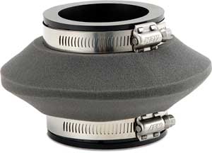

A little crazy glue would fix that right up. Then you can put it in the for sale Section : MINT KA24DE, REBUILT!!
http://www.tirerack.com/images/intake/medium/aem_ABV20401S.jpg
http://www.tirerack.com/intake/aem/air_bypass_valve.jsp
