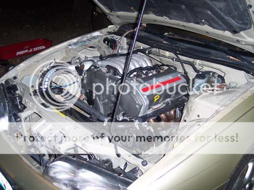

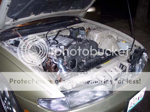

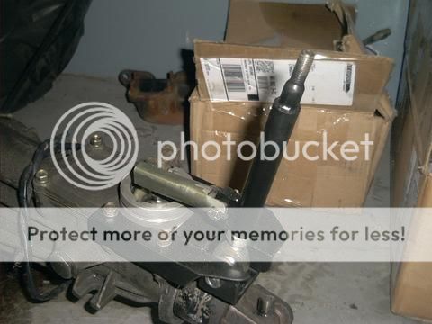

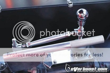

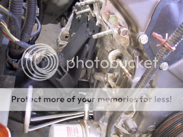

This dude did alot of work… here are a few of his pics
http://i4.photobucket.com/albums/y148/allen22/100_0302.jpg
http://i4.photobucket.com/albums/y148/allen22/100_0304.jpg
http://i4.photobucket.com/albums/y148/allen22/shifter2.jpg
http://i4.photobucket.com/albums/y148/allen22/shifterJPG.jpg

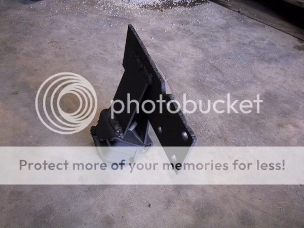

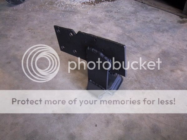

his motor mount setup…
http://i4.photobucket.com/albums/y148/allen22/rhmountoncar.jpg
http://i4.photobucket.com/albums/y148/allen22/lhmount.jpg
http://i4.photobucket.com/albums/y148/allen22/lhmount2.jpg
I used Subaru Forester mounts to start from and just welded to them. The welds are ugly but they seem strong enough.

best off ipmorting a VG30DET, not a tt, single turbo already. Came in the nissan leopard and a few others.
I belive the pics above use the DET’s intake.
But like i say, if you want to do the swap, import a VG30DET from japan.
thanks alot guys, this info is good stuff, do all vg swaps require to move the brake master cylinder over towards the driver ? some people seem to do it for some reason, but not in these pics
Thats a Single Plenum Single TB Intake Manifold from a VQ35 no?
VG’s never had Single Plenum Single TB Intake Manifolds…
It’s a VG30 just a gay fwd vg out of like a 95-98 max.
