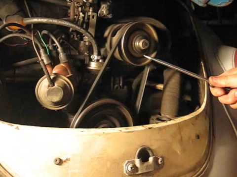

If you want to try it out yourself, loosen the top alternator bolt, get a flathead screwdriver, shove that in between the block and the alternator, and tighten it back up
:tup:
Like to see that trick on a serpentine belt !
not while the car is on,lol.
Simple yet impressive.
