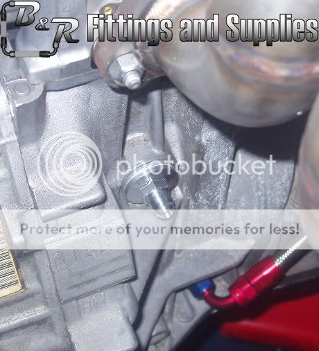

b&r fittings kicks ass, i got lots of fittings on my motor from them. good shit, pricey but what can you do.
-10an vs -8an oil drain

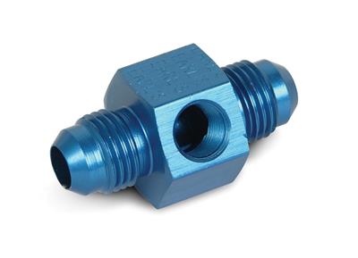

So of course the new fuel pressure sender doesn’t fit next to the fuel pressure regulator! Its b/c I used a Jackson fuel rail adapter to angle the regulator away so it would clear my manifold. Im looking into adding a gauge adapter.

And now since my old drain was 1/2npt and the new one is 3/8npt I have to order a 3/8npt to -10an fitting.
