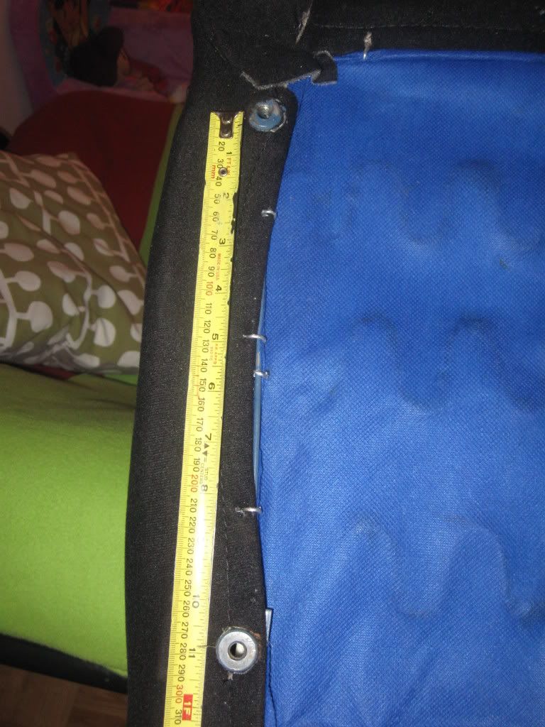

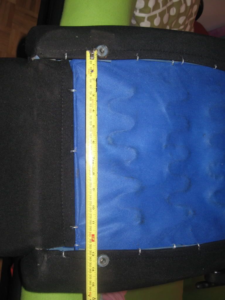

So it looks like the bottom measurements are 13.5" width by 11" length.
I wonder if those length’s match closely with the S14 stock rails?
If so, they would theoretically bolt into the car, and may just need some adjustment to sit low enough?
If anyone knows the stock dimension, let me know please.

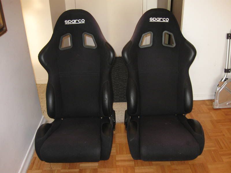

Here are some pics.
Any easy way to tell if these are knock-off’s?
